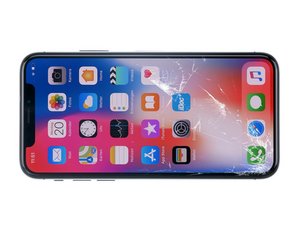

whole iPhone X Display repair guide (with reassembly)
Introduction
Use the english subtitle on YouTube!
Back up all your data before the repair, and touch something metal, like a radiator to get rid of any static charges. The repair is a little more difficult and you need 60-90 minutes.
We recommend these tools for this repair: Pentalobe screwdriver, Phillips screwdriver, Y-type screwdriver, pick, suction cup, spatula, tweezers and spudger. You also need a heat gun to unglue the display.
The Y-type screws have also been called tri-point or tri-wing screws. Tri-point screwdrivers don't fit right and can strip your screw heads. Use a Y-type screwdriver that fits well (Wiha Picofinish Y000).
