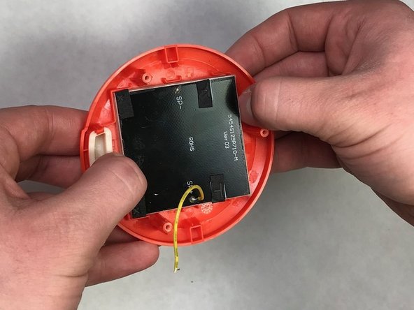

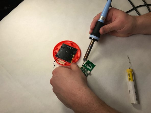

    • Desolder the yellow and black wires that connect the solar panel to the circuit board.
    • Remove the solar panel by pressing on the mounting clips (underneath fingers) using the spudger.
  4. d.light Solar Lantern S2 Solar Panel Replacement: crwdns2935265:04crwdnd2935265:01crwdnd2935265:02crwdne2935265:0 d.light Solar Lantern S2 Solar Panel Replacement: crwdns2935265:04crwdnd2935265:02crwdnd2935265:02crwdne2935265:0
    • Solder the wires to the solar panel (positive to positive, negative to negative).
