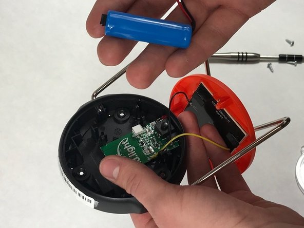

    • To remove the lens, three T15 x 12.5mm screws must be removed by a T15 head screwdriver.
    • The location of the other two screws are marked in red.
  2. d.light Solar Lantern S2 Battery Replacement: crwdns2935265:02crwdnd2935265:01crwdnd2935265:03crwdne2935265:0 d.light Solar Lantern S2 Battery Replacement: crwdns2935265:02crwdnd2935265:02crwdnd2935265:03crwdne2935265:0 d.light Solar Lantern S2 Battery Replacement: crwdns2935265:02crwdnd2935265:03crwdnd2935265:03crwdne2935265:0
    • After the lens has been removed the back cover needs to be removed. There are no snaps or screws holding it in place.
  3. d.light Solar Lantern S2 Battery Replacement: crwdns2935265:03crwdnd2935265:01crwdnd2935265:03crwdne2935265:0 d.light Solar Lantern S2 Battery Replacement: crwdns2935265:03crwdnd2935265:02crwdnd2935265:03crwdne2935265:0 d.light Solar Lantern S2 Battery Replacement: crwdns2935265:03crwdnd2935265:03crwdnd2935265:03crwdne2935265:0

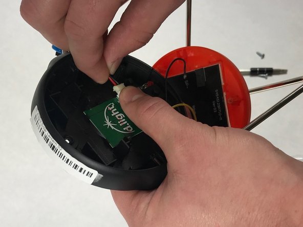

    • Take the battery out of its setting. It is only held in by friction (no snaps or screws).
    • Disconnect the battery by unpluging the white connector.
    • Install the new battery
