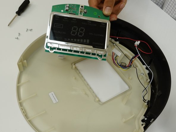

    • Flip bOb back over so you can see the screen. Lift the cover up to reveal bObsweep’s main board.
    • Detach the power inlet from the cover. Grip it and slide it out.
  4. bObsweep Pethair LCD Screen Replacement: crwdns2935265:04crwdnd2935265:01crwdnd2935265:02crwdne2935265:0 bObsweep Pethair LCD Screen Replacement: crwdns2935265:04crwdnd2935265:02crwdnd2935265:02crwdne2935265:0
    • Remove three circuit plugs from the motherboard. Pinch the small white tab on the side of each circuit plug and pull straight up to release each from the motherboard.
    • 1. On the bottom left corner: a small connector with red, black and white wires.
    • 2. One thick white wire that attaches on the right side of the previous connector.
    • 3. On the top edge of bOb’s motherboard: a wide multicoloured connector.
    • Place the cover aside and begin your repair.

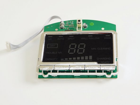

  5. bObsweep Pethair LCD Screen Replacement, bObsweep Pethair's LCD Screen: crwdns2935265:05crwdnd2935265:01crwdnd2935265:03crwdne2935265:0 bObsweep Pethair LCD Screen Replacement, bObsweep Pethair's LCD Screen: crwdns2935265:05crwdnd2935265:02crwdnd2935265:03crwdne2935265:0 bObsweep Pethair LCD Screen Replacement, bObsweep Pethair's LCD Screen: crwdns2935265:05crwdnd2935265:03crwdnd2935265:03crwdne2935265:0

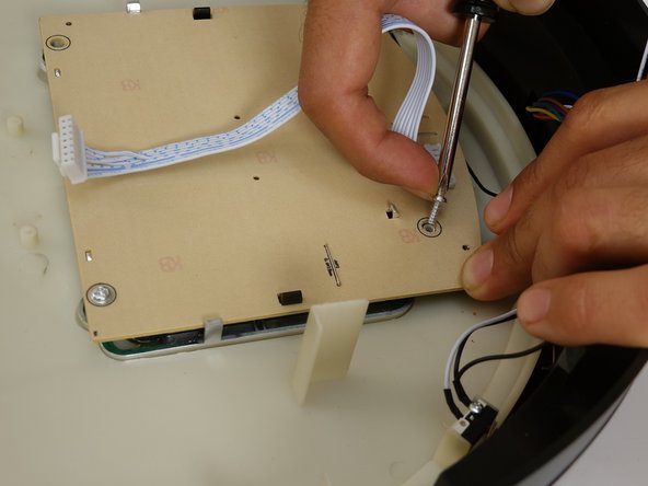

    • Remove the four screws holding the screen in place
    • Lift the screen up and it will detach from the cover.
  6. bObsweep Pethair LCD Screen Replacement: crwdns2935265:06crwdnd2935265:01crwdnd2935265:03crwdne2935265:0 bObsweep Pethair LCD Screen Replacement: crwdns2935265:06crwdnd2935265:02crwdnd2935265:03crwdne2935265:0 bObsweep Pethair LCD Screen Replacement: crwdns2935265:06crwdnd2935265:03crwdnd2935265:03crwdne2935265:0
    • The screen and cover buttons will lift out together, leaving an open space for your replacement parts to fit into.

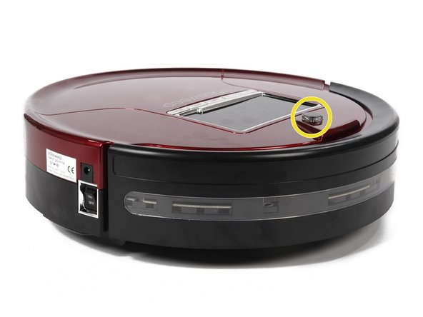

    • If you remove the infrared sensor, replace it in its space on the new cover so the black side will be on bOb’s outside.
    • Then, install all four screws for the LCD display. To finish off the repair, simply follow: Closing bObsweep's cover after repair
