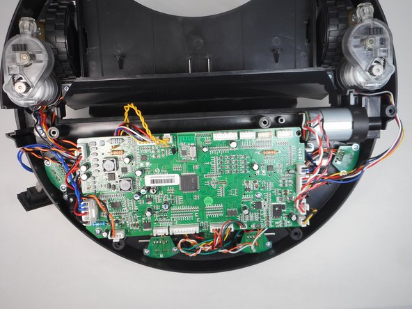

    • Carefully hold the top and bottom halves together and flip the bObsweep upright.
    • Lift the cover to reveal the mainboard.

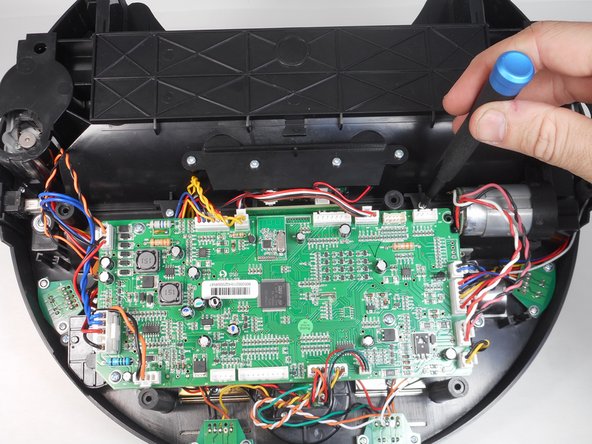

    • Depress the tabs on the circuit plugs and lift them directly upward to remove:
    • The multicolored nine-wire circuit plug at the top edge of the board.
    • The red and black wire circuit plug directly next to it.
    • The seven white wire circuit plug on the bottom edge of the board.
    • The red, white, and black wire circuit plug on the bottom left corner of the board.

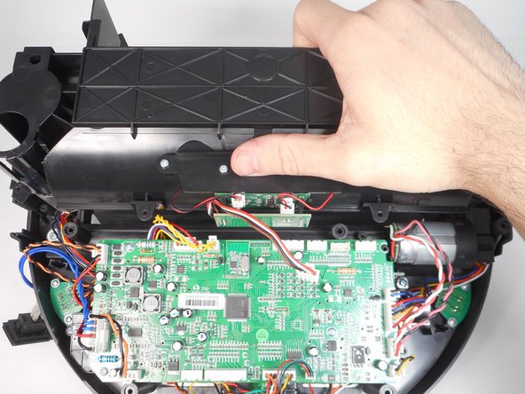

  7. bObsweep PetHair Plus WPP56002 Wheel Motor Replacement, Wheel Motor: crwdns2935265:07crwdnd2935265:01crwdnd2935265:03crwdne2935265:0 bObsweep PetHair Plus WPP56002 Wheel Motor Replacement, Wheel Motor: crwdns2935265:07crwdnd2935265:02crwdnd2935265:03crwdne2935265:0 bObsweep PetHair Plus WPP56002 Wheel Motor Replacement, Wheel Motor: crwdns2935265:07crwdnd2935265:03crwdnd2935265:03crwdne2935265:0
    • Unscrew the six screws (9.9 mm Phillips #1) securing the wheel cover.
    • The main brush motor and power switch may need to be moved to access these securing screws.
    • Remove the wheel cover from the mainboard.

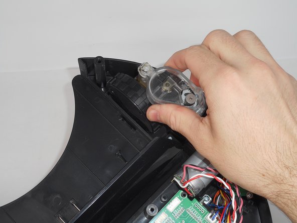

  8. bObsweep PetHair Plus WPP56002 Wheel Motor Replacement: crwdns2935265:08crwdnd2935265:01crwdnd2935265:01crwdne2935265:0
    • Remove the wheel springs and set them aside so they are not misplaced.
  9. bObsweep PetHair Plus WPP56002 Wheel Motor Replacement: crwdns2935265:09crwdnd2935265:01crwdnd2935265:02crwdne2935265:0 bObsweep PetHair Plus WPP56002 Wheel Motor Replacement: crwdns2935265:09crwdnd2935265:02crwdnd2935265:02crwdne2935265:0
    • Extract the malfunctioning wheel.
    • Unplug the wheel from the mainboard.
