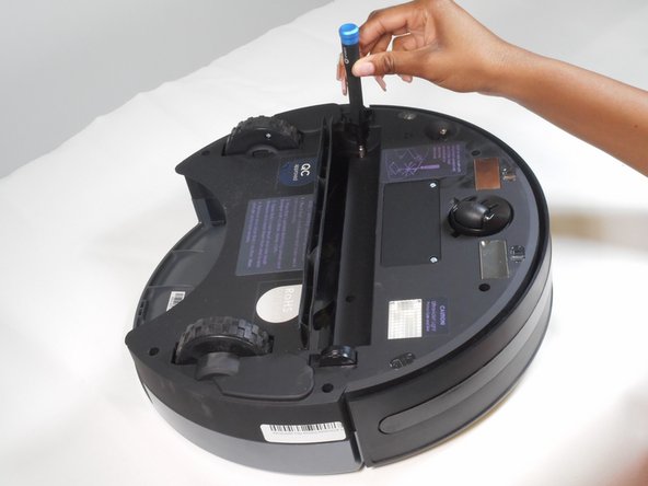

    • Flip the bObsweep over and remove the main brush’s screw (13.7mm Flat) with a flathead screwdriver.
    • Lift and remove the main brush and its plastic bearing end cap.

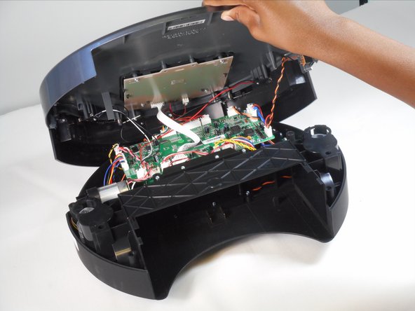

    • Carefully hold the top and bottom halves together and flip the bObsweep upright.
    • Lift the cover to reveal the mainboard.

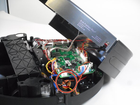

    • Depress the tabs on the circuit plugs and lift them directly upward to remove:
    • The multicolored nine-wire circuit plug at the top edge of the board.
    • The red and black wire circuit plug directly next to it.
    • The seven white wire circuit plug on the bottom edge of the board.
    • The red, white, and black wire circuit plug on the bottom left corner of the board.

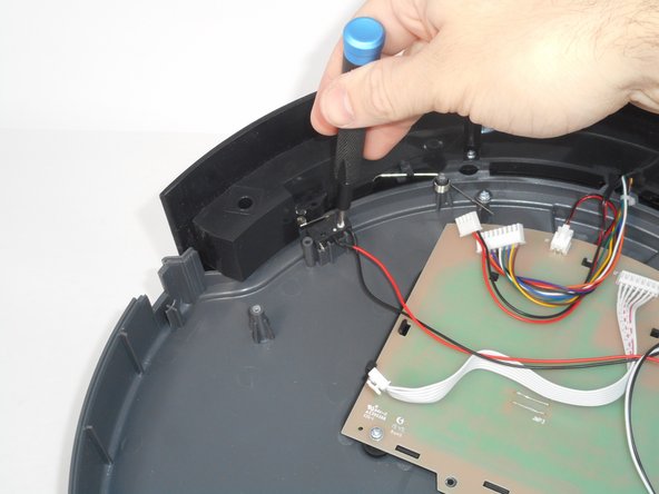

  7. bObsweep PetHair Plus WPP56002 Touch Sensor Replacement, Touch Sensor: crwdns2935265:07crwdnd2935265:01crwdnd2935265:02crwdne2935265:0 bObsweep PetHair Plus WPP56002 Touch Sensor Replacement, Touch Sensor: crwdns2935265:07crwdnd2935265:02crwdnd2935265:02crwdne2935265:0
    • Remove and set aside the screw (10.8 mm Phillips #1) on each sensor.

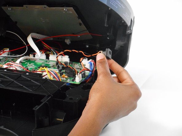

  8. bObsweep PetHair Plus WPP56002 Touch Sensor Replacement: crwdns2935265:08crwdnd2935265:01crwdnd2935265:01crwdne2935265:0
    • Lift the sensors to extract them.
  9. bObsweep PetHair Plus WPP56002 Touch Sensor Replacement: crwdns2935265:09crwdnd2935265:01crwdnd2935265:01crwdne2935265:0
    • Install the new sensors.
    • Ensure the red-wired sensor is on the left side and the black-wired sensor is on the right.
