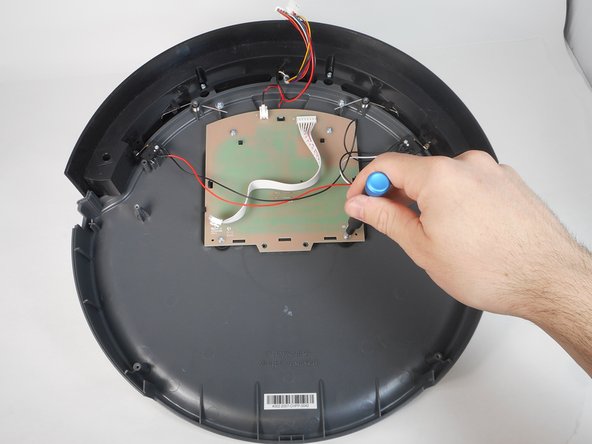

  7. bObsweep PetHair Plus WPP56002 LED Screen Replacement, LED Screen: crwdns2935265:07crwdnd2935265:01crwdnd2935265:02crwdne2935265:0 bObsweep PetHair Plus WPP56002 LED Screen Replacement, LED Screen: crwdns2935265:07crwdnd2935265:02crwdnd2935265:02crwdne2935265:0
    • Remove and set aside the four screws (9.7 mm Phillips #1) on the underside of the cover that secure the screen.
  8. bObsweep PetHair Plus WPP56002 LED Screen Replacement: crwdns2935265:08crwdnd2935265:01crwdnd2935265:01crwdne2935265:0
    • Lift the screen out, moving aside any wires as needed.
  9. bObsweep PetHair Plus WPP56002 LED Screen Replacement: crwdns2935265:09crwdnd2935265:01crwdnd2935265:01crwdne2935265:0
    • Align the new screen facedown with the screw posts on the cover.
