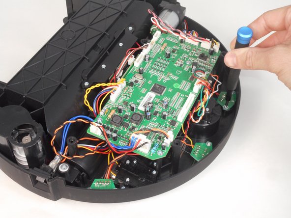

  4. bObsweep PetHair Plus WPP56002 Edge Sensor Replacement: crwdns2935265:04crwdnd2935265:01crwdnd2935265:02crwdne2935265:0 bObsweep PetHair Plus WPP56002 Edge Sensor Replacement: crwdns2935265:04crwdnd2935265:02crwdnd2935265:02crwdne2935265:0
    • Carefully hold the top and bottom halves together and flip the bObsweep upright.
    • Lift the cover to reveal the mainboard.

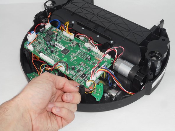

  5. bObsweep PetHair Plus WPP56002 Edge Sensor Replacement: crwdns2935265:05crwdnd2935265:01crwdnd2935265:03crwdne2935265:0 bObsweep PetHair Plus WPP56002 Edge Sensor Replacement: crwdns2935265:05crwdnd2935265:02crwdnd2935265:03crwdne2935265:0 bObsweep PetHair Plus WPP56002 Edge Sensor Replacement: crwdns2935265:05crwdnd2935265:03crwdnd2935265:03crwdne2935265:0
    • Slide the power inlet down.
    • Tuck it aside to protect it from damage.

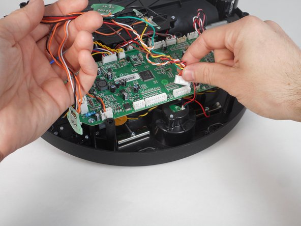

  6. bObsweep PetHair Plus WPP56002 Edge Sensor Replacement: crwdns2935265:06crwdnd2935265:01crwdnd2935265:03crwdne2935265:0 bObsweep PetHair Plus WPP56002 Edge Sensor Replacement: crwdns2935265:06crwdnd2935265:02crwdnd2935265:03crwdne2935265:0 bObsweep PetHair Plus WPP56002 Edge Sensor Replacement: crwdns2935265:06crwdnd2935265:03crwdnd2935265:03crwdne2935265:0
    • Depress the tabs on the circuit plugs and lift them directly upward to remove:
    • The multicolored nine-wire circuit plug at the top edge of the board.
    • The red and black wire circuit plug directly next to it.
    • The seven white wire circuit plug on the bottom edge of the board.
    • The red, white, and black wire circuit plug on the bottom left corner of the board.
  7. bObsweep PetHair Plus WPP56002 Edge Sensor Replacement, Edge Sensor: crwdns2935265:07crwdnd2935265:01crwdnd2935265:02crwdne2935265:0 bObsweep PetHair Plus WPP56002 Edge Sensor Replacement, Edge Sensor: crwdns2935265:07crwdnd2935265:02crwdnd2935265:02crwdne2935265:0
    • Remove two screws (7.5 mm Phillips #1) from each of the four sensors and set them aside.

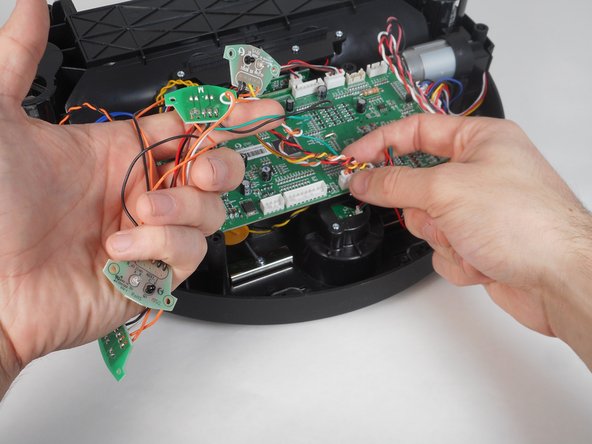

  8. bObsweep PetHair Plus WPP56002 Edge Sensor Replacement: crwdns2935265:08crwdnd2935265:01crwdnd2935265:03crwdne2935265:0 bObsweep PetHair Plus WPP56002 Edge Sensor Replacement: crwdns2935265:08crwdnd2935265:02crwdnd2935265:03crwdne2935265:0 bObsweep PetHair Plus WPP56002 Edge Sensor Replacement: crwdns2935265:08crwdnd2935265:03crwdnd2935265:03crwdne2935265:0
    • Pass the wiring of the two outermost sensors under the main board, toward the front wheel.
    • Disconnect the sensors from the mainboard by depressing the small tabs on the side of each circuit plug.
    • Lift the sensors up and out, leaving the plastic sensor covers in place.
  9. bObsweep PetHair Plus WPP56002 Edge Sensor Replacement: crwdns2935265:09crwdnd2935265:01crwdnd2935265:02crwdne2935265:0 bObsweep PetHair Plus WPP56002 Edge Sensor Replacement: crwdns2935265:09crwdnd2935265:02crwdnd2935265:02crwdne2935265:0
    • Install the new sensors by plugging them into the mainboard, ensuring the wiring of the two outermost sensors are passed back under the board.
    • Each sensor should be placed over the plastic sensor covers with the green side facing upward.
