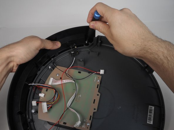

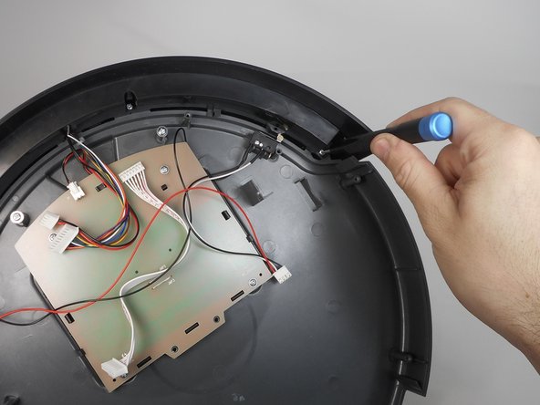

  7. bObsweep PetHair Plus WPP56002 Bumper Replacement, Bumper: crwdns2935265:07crwdnd2935265:01crwdnd2935265:03crwdne2935265:0 bObsweep PetHair Plus WPP56002 Bumper Replacement, Bumper: crwdns2935265:07crwdnd2935265:02crwdnd2935265:03crwdne2935265:0 bObsweep PetHair Plus WPP56002 Bumper Replacement, Bumper: crwdns2935265:07crwdnd2935265:03crwdnd2935265:03crwdne2935265:0
    • Remove and set aside the two springs on either side of the screen.
    • Remove the four screws (9.9 mm Phillips #1).
  8. bObsweep PetHair Plus WPP56002 Bumper Replacement: crwdns2935265:08crwdnd2935265:01crwdnd2935265:01crwdne2935265:0
    • Lift to disconnect the bumper.
    • Separate it into its three components (a large exterior piece, a small, wired piece, and a plastic strip).

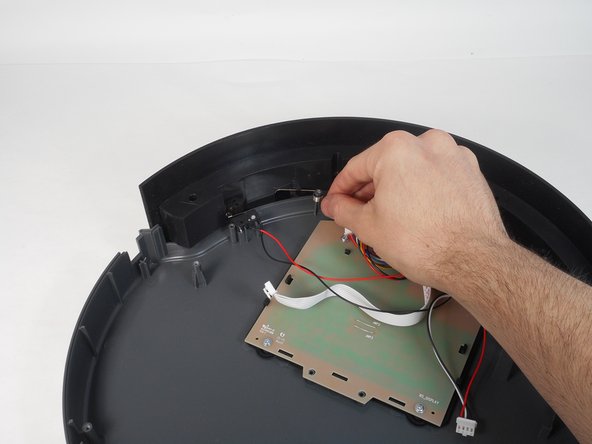

  9. bObsweep PetHair Plus WPP56002 Bumper Replacement: crwdns2935265:09crwdnd2935265:01crwdnd2935265:01crwdne2935265:0
    • Place the cover on top of the large exterior piece.
    • Ensure the screw posts protrude through the cover’s corresponding holes.
  10. bObsweep PetHair Plus WPP56002 Bumper Replacement: crwdns2935265:010crwdnd2935265:01crwdnd2935265:02crwdne2935265:0 bObsweep PetHair Plus WPP56002 Bumper Replacement: crwdns2935265:010crwdnd2935265:02crwdnd2935265:02crwdne2935265:0
    • Install the new obstacle sensor (the small, wired piece).
    • Note: If needed, slightly lift the bumper so the two parts touch.
    • Ensure it is lined up with the screw posts and no wires are compressed between the two parts.
