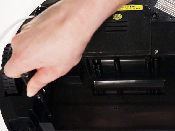

    • Remove bObi’s front wheel to access one of the screws holding bObi together.
    • Make sure the wheel is turned closer to bObi's front touch sensors. Use your screwdriver for leverage, and the wheel will pop up and out.
    • Uninstall the larger screw that sits deeper in the wheel compartment.

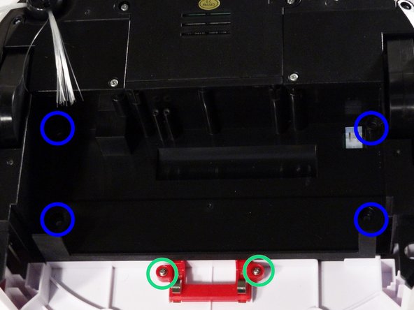

    • Remove bObi's dustbin.
    • Uninstall the 2 screws close to the bin and 2 smaller screws above her main brushes.
  3. bObi Robotic Vacuum Screen Replacement: crwdns2935265:03crwdnd2935265:01crwdnd2935265:03crwdne2935265:0 bObi Robotic Vacuum Screen Replacement: crwdns2935265:03crwdnd2935265:02crwdnd2935265:03crwdne2935265:0 bObi Robotic Vacuum Screen Replacement: crwdns2935265:03crwdnd2935265:03crwdnd2935265:03crwdne2935265:0
    • Lift the brush holder. To detach completely, unplug it from bObi.
    • Remove the two screws on the dustbin contact point holder inside bObi.
    • There are 4 screws beneath the main brushes. Uninstall these, and open bObi up to expose her main circuit board.

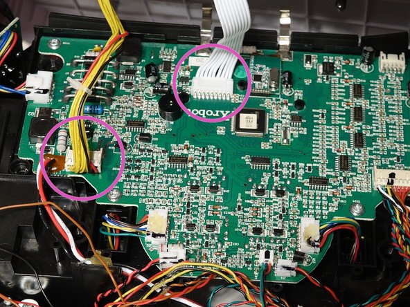

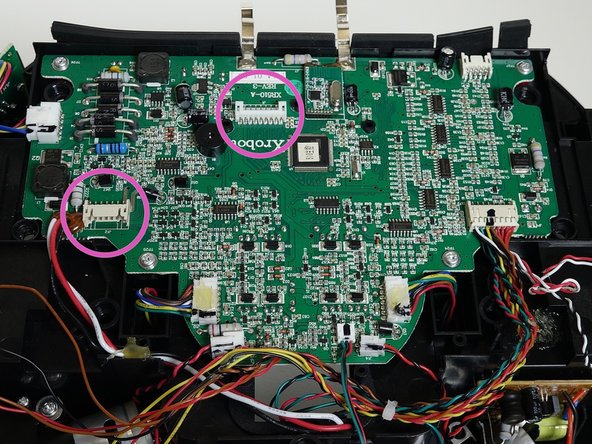

  4. bObi Robotic Vacuum Screen Replacement: crwdns2935265:04crwdnd2935265:01crwdnd2935265:03crwdne2935265:0 bObi Robotic Vacuum Screen Replacement: crwdns2935265:04crwdnd2935265:02crwdnd2935265:03crwdne2935265:0 bObi Robotic Vacuum Screen Replacement: crwdns2935265:04crwdnd2935265:03crwdnd2935265:03crwdne2935265:0

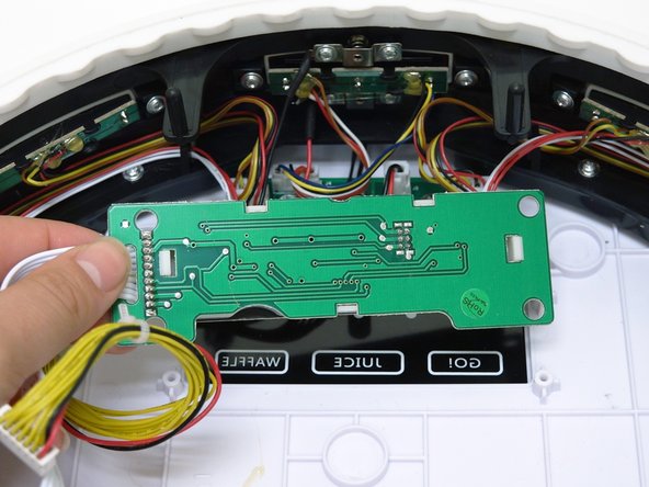

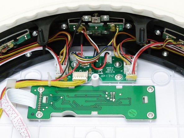

    • Detach the two circuit plugs connecting bObi's cover to the main board and the cover will be completely removed.
  5. bObi Robotic Vacuum Screen Replacement, Screen: crwdns2935265:05crwdnd2935265:01crwdnd2935265:02crwdne2935265:0 bObi Robotic Vacuum Screen Replacement, Screen: crwdns2935265:05crwdnd2935265:02crwdnd2935265:02crwdne2935265:0
    • Remove the four screws that secure bObi's screen and lift the whole piece out.
    • Put the replacement screen in the open space.
