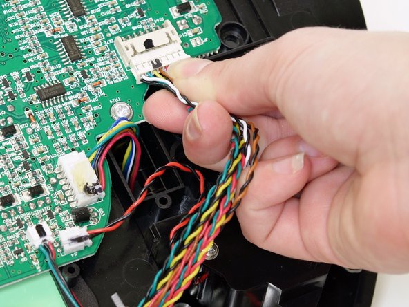

    • There are 4 screws beneath the main brushes. Uninstall these, and open bObi up to expose her main circuit board.
  4. bObi Robotic Vacuum Ground Sensor Replacement: crwdns2935265:04crwdnd2935265:01crwdnd2935265:03crwdne2935265:0 bObi Robotic Vacuum Ground Sensor Replacement: crwdns2935265:04crwdnd2935265:02crwdnd2935265:03crwdne2935265:0 bObi Robotic Vacuum Ground Sensor Replacement: crwdns2935265:04crwdnd2935265:03crwdnd2935265:03crwdne2935265:0
    • Detach the two circuit plugs connecting bObi's cover to the main board and the cover will be completely removed.
  5. bObi Robotic Vacuum Ground Sensor Replacement, Floor sensors: crwdns2935265:05crwdnd2935265:01crwdnd2935265:02crwdne2935265:0 bObi Robotic Vacuum Ground Sensor Replacement, Floor sensors: crwdns2935265:05crwdnd2935265:02crwdnd2935265:02crwdne2935265:0
    • The four floor detecting sensors plug in on the left of bObi’s front wheel. Pull to unplug it.
    • If the wires are glued down to bObi’s frame, simply pull up to detach them, then remove the circuit plug.
