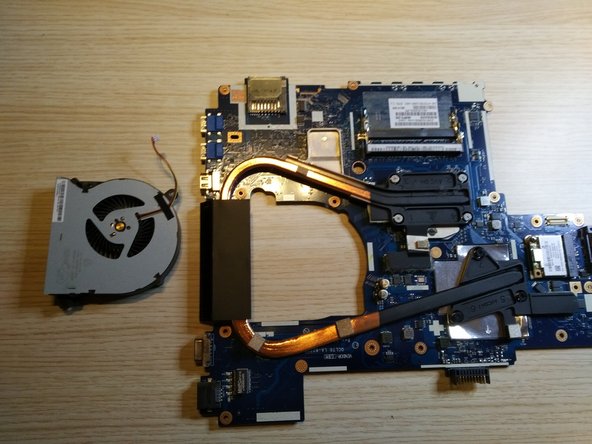

  14. asus laptop k75vm replacing the broken lcd cable Replacement: crwdns2935265:014crwdnd2935265:01crwdnd2935265:03crwdne2935265:0 asus laptop k75vm replacing the broken lcd cable Replacement: crwdns2935265:014crwdnd2935265:02crwdnd2935265:03crwdne2935265:0 asus laptop k75vm replacing the broken lcd cable Replacement: crwdns2935265:014crwdnd2935265:03crwdnd2935265:03crwdne2935265:0
    • remove the 3 screws seen in picture 1
    • remove 1 screw on the left side from the LCD connector.
    • after that, you can slide the main board out. ( lift it up on the right side, then slide to the right and take it out. )
    • when you want to remove the fan as well ( or replace it) you have to remove 3 screws, see picture 3

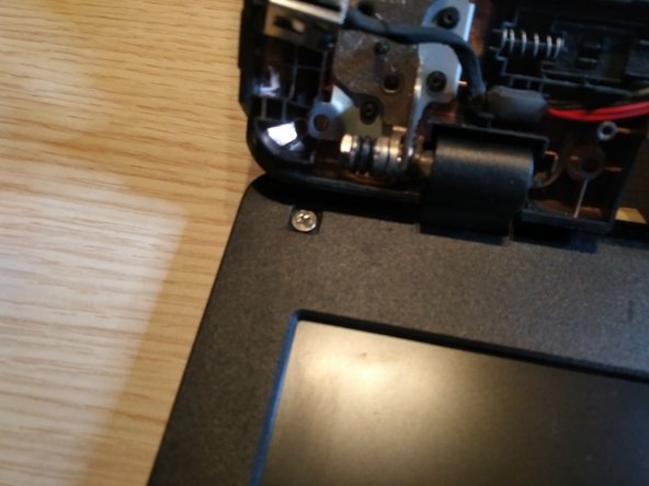

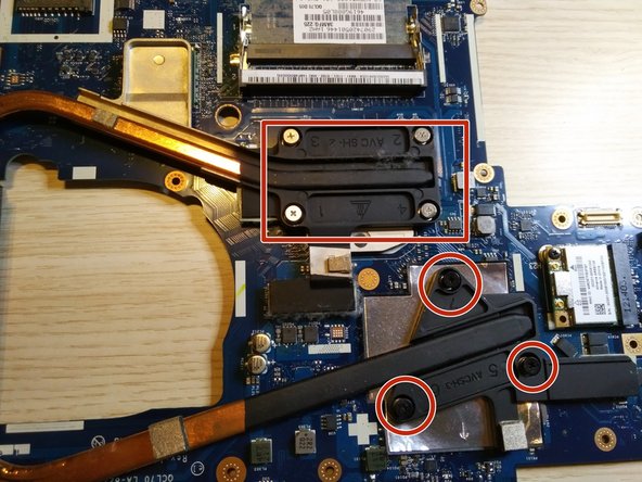

  15. asus laptop k75vm replacing the broken lcd cable Replacement: crwdns2935265:015crwdnd2935265:01crwdnd2935265:03crwdne2935265:0 asus laptop k75vm replacing the broken lcd cable Replacement: crwdns2935265:015crwdnd2935265:02crwdnd2935265:03crwdne2935265:0 asus laptop k75vm replacing the broken lcd cable Replacement: crwdns2935265:015crwdnd2935265:03crwdnd2935265:03crwdne2935265:0
    • after removing the main board you have a view of the henges from the screen.
    • in picture 2 you will see the main board. , you can clean and or replace the CPU now.
    • to replace a cpu or clean the pads you will have to remove the screws seen in picture 3 .
    • clean the pads with isopropyl alcohol and always renew the CPU thermal paste . ( one drop on each spot is enough)
  16. asus laptop k75vm replacing the broken lcd cable Replacement: crwdns2935265:016crwdnd2935265:01crwdnd2935265:02crwdne2935265:0 asus laptop k75vm replacing the broken lcd cable Replacement: crwdns2935265:016crwdnd2935265:02crwdnd2935265:02crwdne2935265:0
    • remove the 3 screws on each hinge
    • on the right hinge there is a metal hook attached on the hinge. this is attached to the bottom case .. just move the screen to release it.
