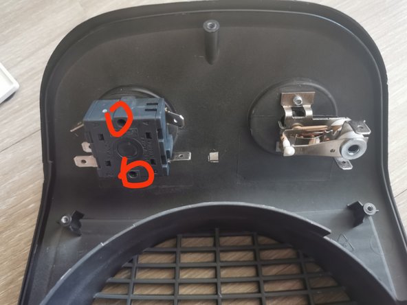

    • Pry open the two knobs (they are plugged in), you can see two screws on each side, unscrew them to remove the gear switch and temperature switch.

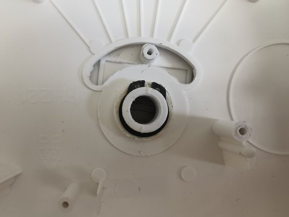

    • Unscrew these two screws to separate the upper and lower parts.
    • Pallets require special tools to separate.

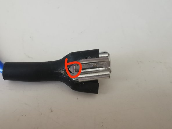

    • As shown at the bottom, just unscrew all the phillips screws.
    • Note: All terminals can be pulled out only by pressing the part shown in Figure 2 with a small or a tool, and should not use brute force.
