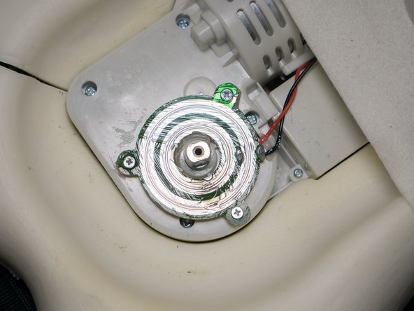

  4. Zyllion ZMA-13-BK Shiatsu Massage Pillow Heater Replacement: crwdns2935265:04crwdnd2935265:01crwdnd2935265:02crwdne2935265:0 Zyllion ZMA-13-BK Shiatsu Massage Pillow Heater Replacement: crwdns2935265:04crwdnd2935265:02crwdnd2935265:02crwdne2935265:0
    • Remove the entire heater from the pillow.
    • You can see a green circuit board after removing the heater.
  5. Zyllion ZMA-13-BK Shiatsu Massage Pillow Heater Replacement: crwdns2935265:05crwdnd2935265:01crwdnd2935265:01crwdne2935265:0
    • Using the Phillips JIS #1 screwdriver, remove the three screws circled in the picture.
    • All three screws are 8.0mm, which are the same size as the previous one. They are interchangeable.
  6. Zyllion ZMA-13-BK Shiatsu Massage Pillow Heater Replacement: crwdns2935265:06crwdnd2935265:01crwdnd2935265:01crwdne2935265:0
    • Now you can take out the circuit board. There will be two wires attached to the circuit board.
    • If you prefer, you can clean the circuit board gently with dry tissues to remove the sticky lubricant.
