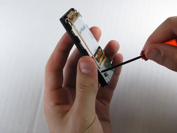

  6. Zune Flash 2nd Generation Communications Board Replacement, Communications Board: crwdns2935265:06crwdnd2935265:01crwdnd2935265:02crwdne2935265:0 Zune Flash 2nd Generation Communications Board Replacement, Communications Board: crwdns2935265:06crwdnd2935265:02crwdnd2935265:02crwdne2935265:0
    • Remove the three screws (5.5mm by 3mm) from the backside of the Zune using a small Tri-Wing screwdriver.

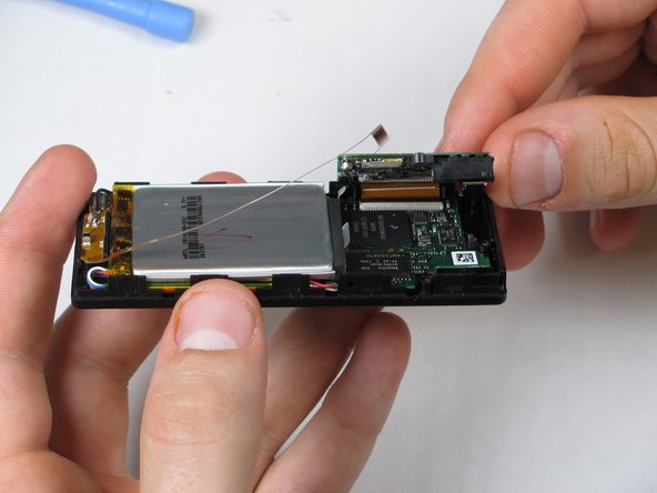

  8. Zune Flash 2nd Generation Communications Board Replacement: crwdns2935265:08crwdnd2935265:01crwdnd2935265:01crwdne2935265:0
    • Disconnect the ribbon cable with the Zune opening tool by flipping up the black plastic flap where the ribbon cable connects to the memory board.
    • Pull the ribbon cable out of the memory board.
  9. Zune Flash 2nd Generation Communications Board Replacement: crwdns2935265:09crwdnd2935265:01crwdnd2935265:01crwdne2935265:0
    • Peal the slim ribbon cable off the communications board using your fingers.
    • This slim ribbon is attached using an adhesive, so it cannot be reattached without more adhesive.
  10. Zune Flash 2nd Generation Communications Board Replacement: crwdns2935265:010crwdnd2935265:01crwdnd2935265:02crwdne2935265:0 Zune Flash 2nd Generation Communications Board Replacement: crwdns2935265:010crwdnd2935265:02crwdnd2935265:02crwdne2935265:0
    • Pull the cable connector straight up using your fingers.
    • Communications board remains.
