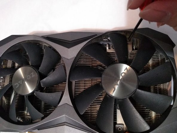

    • Be sure to properly ground yourself with an anti-static wristband before working on the graphics card.
    • Use a Phillips #0 screwdriver to remove the two 4mm screws from the right side of the shroud.
  2. Zotac GTX 1080 Ti Mini Fans Replacement: crwdns2935265:02crwdnd2935265:01crwdnd2935265:02crwdne2935265:0 Zotac GTX 1080 Ti Mini Fans Replacement: crwdns2935265:02crwdnd2935265:02crwdnd2935265:02crwdne2935265:0
    • Use a Phillips #0 screwdriver to remove the two 4mm screws from the left side of the shroud.

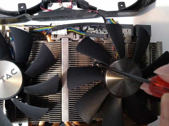

  3. Zotac GTX 1080 Ti Mini Fans Replacement: crwdns2935265:03crwdnd2935265:01crwdnd2935265:02crwdne2935265:0 Zotac GTX 1080 Ti Mini Fans Replacement: crwdns2935265:03crwdnd2935265:02crwdnd2935265:02crwdne2935265:0
    • Look for the fan header located beside the 16-pin power connector.
    • Gently pry the fan connector apart from the header with a flathead screwdriver.
  4. Zotac GTX 1080 Ti Mini Fans Replacement: crwdns2935265:04crwdnd2935265:01crwdnd2935265:02crwdne2935265:0 Zotac GTX 1080 Ti Mini Fans Replacement: crwdns2935265:04crwdnd2935265:02crwdnd2935265:02crwdne2935265:0
    • Slowly and carefully lift the shroud off the heatsink.
    • During this step, make sure not to damage the LED connector that is still connecting the shroud to the PCB.
    • Flip the shroud along the top of the graphics card.

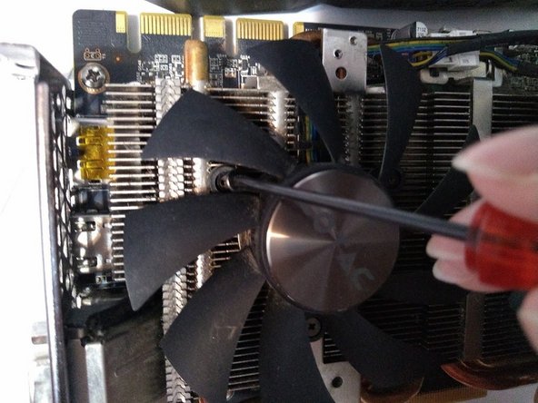

  5. Zotac GTX 1080 Ti Mini Fans Replacement: crwdns2935265:05crwdnd2935265:01crwdnd2935265:03crwdne2935265:0 Zotac GTX 1080 Ti Mini Fans Replacement: crwdns2935265:05crwdnd2935265:02crwdnd2935265:03crwdne2935265:0 Zotac GTX 1080 Ti Mini Fans Replacement: crwdns2935265:05crwdnd2935265:03crwdnd2935265:03crwdne2935265:0
    • Remove the three 3 mm Phillips screws holding the fans to the heatsink with a Phillips #0 screwdriver.
    • Remove the broken fans.

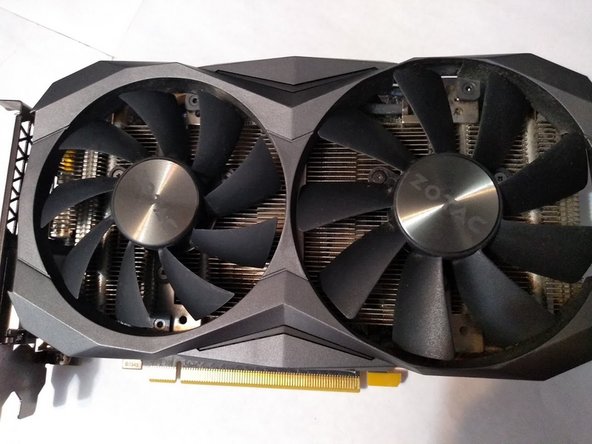

    • Place the shroud back over the heatsink and screw it back into place using a Phillips #0 screwdriver.
Hopefully, your graphics card is fully replaced and completely working now.
