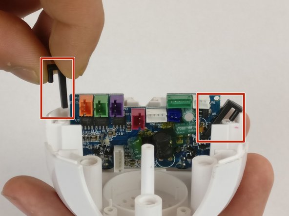

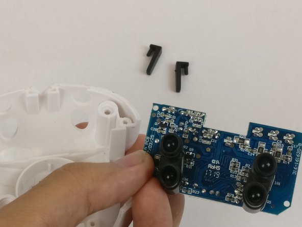

  3. Zoomer Show Pony Sensor Replacement: crwdns2935265:03crwdnd2935265:01crwdnd2935265:03crwdne2935265:0 Zoomer Show Pony Sensor Replacement: crwdns2935265:03crwdnd2935265:02crwdnd2935265:03crwdne2935265:0 Zoomer Show Pony Sensor Replacement: crwdns2935265:03crwdnd2935265:03crwdnd2935265:03crwdne2935265:0
    • Take out the two clips keeping the motherboard in place but applying upwards pressure on them.
    • Remove the motherboard and replace. The sensors are soldered on to the motherboard so the whole board must be replaced.
