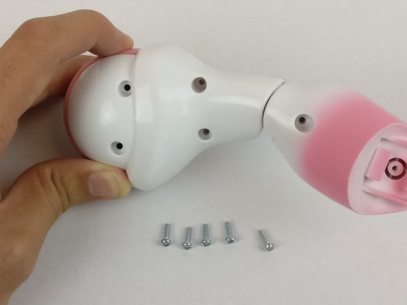

    • Flip the pony over.
    • Remove the five Triangle 3 screws from underneath.
    • The pony will separate into a few pieces once the screws are removed.

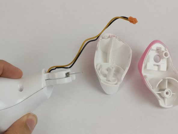

    • Disconnect all of the wires between the head and leg sections.
    • To replace the power/volume switch, remove the two Phillips #0 screws from the switch.
    • Lift the switch out to replace.

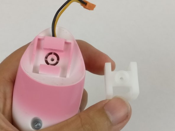

    • Detach the plastic mount at the top of the leg by sliding it in a vertical motion from the position shown.

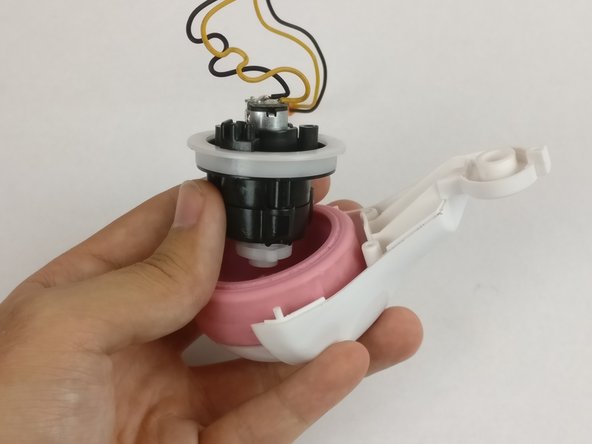

    • Lift up on the plastic housing located on the upper portion of the leg (where it connects to the body).
    • Carefully separate the plastic housing at the base of the leg.
    • Remove slowly, there are small components attached to the motor that could become loose and/or missing.

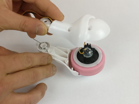

  7. Zoomer Show Pony Leg Motor Replacement: crwdns2935265:07crwdnd2935265:01crwdnd2935265:01crwdne2935265:0
    • The spring will be exposed as shown. Remove the broken or damaged spring and replace it with a new one.
    • Spring must be in the "loaded position" when reassembling (there should be some resistance).

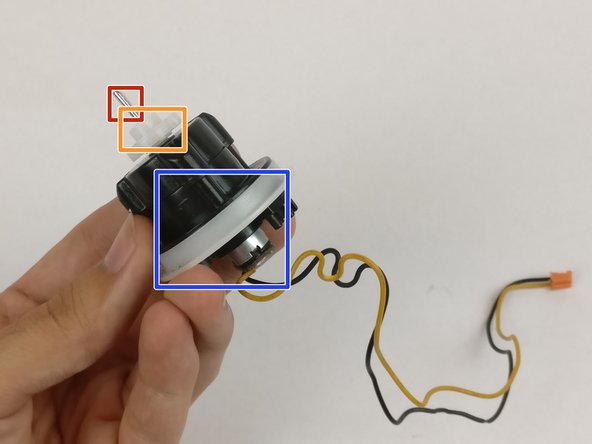

  8. Zoomer Show Pony Leg Motor Replacement, Leg Motor: crwdns2935265:08crwdnd2935265:01crwdnd2935265:03crwdne2935265:0 Zoomer Show Pony Leg Motor Replacement, Leg Motor: crwdns2935265:08crwdnd2935265:02crwdnd2935265:03crwdne2935265:0 Zoomer Show Pony Leg Motor Replacement, Leg Motor: crwdns2935265:08crwdnd2935265:03crwdnd2935265:03crwdne2935265:0
    • Pull motor out of pink wheel
    • Remove pin (red), plastic piece connected to pin (orange), and plastic rim around motor (blue).
  9. Zoomer Show Pony Leg Motor Replacement: crwdns2935265:09crwdnd2935265:01crwdnd2935265:01crwdne2935265:0
    • Replace motor
