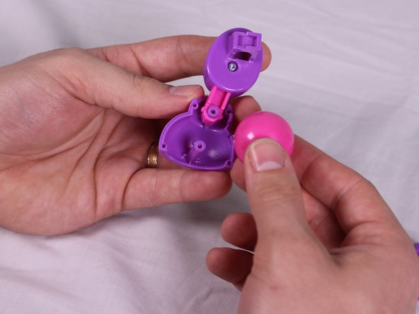

  4. Zoomer Meowzies Wheels Replacement, Wheels: crwdns2935265:04crwdnd2935265:01crwdnd2935265:01crwdne2935265:0
    • Turn the Zoomer Meowzies leg to its side.
    • Using the Triangle driver remove the two bottom 7 mm screws.
  5. Zoomer Meowzies Wheels Replacement: crwdns2935265:05crwdnd2935265:01crwdnd2935265:01crwdne2935265:0
    • Hold both sides of the leg and gently pull apart.
    • If pulled apart too forcefully the rest of the leg may sustain damage. Caution is advised.
  6. Zoomer Meowzies Wheels Replacement: crwdns2935265:06crwdnd2935265:01crwdnd2935265:02crwdne2935265:0 Zoomer Meowzies Wheels Replacement: crwdns2935265:06crwdnd2935265:02crwdnd2935265:02crwdne2935265:0
    • Wheel should now be exposed. Pull wheel up and away from the rest of the leg to remove. Replace with new wheel if necessary.
