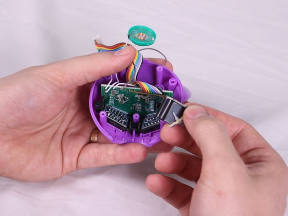

  4. Zoomer Meowzies Eyes/Motherboard Replacement, Head (Bottom): crwdns2935265:04crwdnd2935265:01crwdnd2935265:02crwdne2935265:0 Zoomer Meowzies Eyes/Motherboard Replacement, Head (Bottom): crwdns2935265:04crwdnd2935265:02crwdnd2935265:02crwdne2935265:0
    • Gently pry the ribbon cable from the connector.

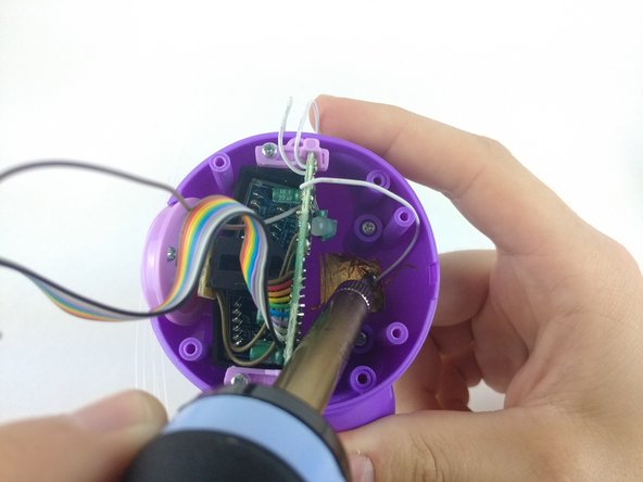

  5. Zoomer Meowzies Eyes/Motherboard Replacement: crwdns2935265:05crwdnd2935265:01crwdnd2935265:03crwdne2935265:0 Zoomer Meowzies Eyes/Motherboard Replacement: crwdns2935265:05crwdnd2935265:02crwdnd2935265:03crwdne2935265:0 Zoomer Meowzies Eyes/Motherboard Replacement: crwdns2935265:05crwdnd2935265:03crwdnd2935265:03crwdne2935265:0
    • Using a soldering Iron, carefully heat the solder point around the silver wire and pull gently until the wire lifts free.
    • The soldering iron and solder get very hot, so caution is advised to avoid touching either directly.
    • This step may be skipped but if so care must be taken to not accidentally pull the wire from the contact. Skipping this step will limit the amount or room that is available to work with.

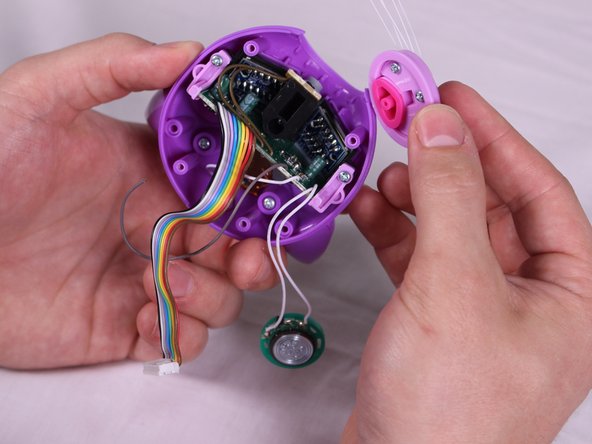

  6. Zoomer Meowzies Eyes/Motherboard Replacement: crwdns2935265:06crwdnd2935265:01crwdnd2935265:03crwdne2935265:0 Zoomer Meowzies Eyes/Motherboard Replacement: crwdns2935265:06crwdnd2935265:02crwdnd2935265:03crwdne2935265:0 Zoomer Meowzies Eyes/Motherboard Replacement: crwdns2935265:06crwdnd2935265:03crwdnd2935265:03crwdne2935265:0
    • Take the upper half of the device in hand.
    • Using the Philips #1 driver remove the two 9.5mm screws.
    • Remove the purple square collar around the neck of the device.
    • The wires can prove difficult to get through the opening in the collar. Move wires through the opening carefully.

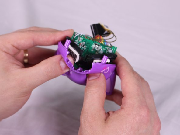

  9. Zoomer Meowzies Eyes/Motherboard Replacement: crwdns2935265:09crwdnd2935265:01crwdnd2935265:03crwdne2935265:0 Zoomer Meowzies Eyes/Motherboard Replacement: crwdns2935265:09crwdnd2935265:02crwdnd2935265:03crwdne2935265:0 Zoomer Meowzies Eyes/Motherboard Replacement: crwdns2935265:09crwdnd2935265:03crwdnd2935265:03crwdne2935265:0

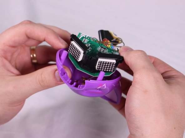

    • Hold the top and bottom halves of the head in each hand separately and gently pull away from each other to separate both halves.
  10. Zoomer Meowzies Eyes/Motherboard Replacement, Eyes/Motherboard: crwdns2935265:010crwdnd2935265:01crwdnd2935265:03crwdne2935265:0 Zoomer Meowzies Eyes/Motherboard Replacement, Eyes/Motherboard: crwdns2935265:010crwdnd2935265:02crwdnd2935265:03crwdne2935265:0 Zoomer Meowzies Eyes/Motherboard Replacement, Eyes/Motherboard: crwdns2935265:010crwdnd2935265:03crwdnd2935265:03crwdne2935265:0
    • With the top half of the head in hand, push the nose in and away from the rest of the head to remove the nose.

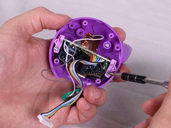

  12. Zoomer Meowzies Eyes/Motherboard Replacement: crwdns2935265:012crwdnd2935265:01crwdnd2935265:02crwdne2935265:0 Zoomer Meowzies Eyes/Motherboard Replacement: crwdns2935265:012crwdnd2935265:02crwdnd2935265:02crwdne2935265:0
    • Using the Phillips #1 driver, remove the two 9.5mm screws located on either sides of the head near the ears.
    • The pink brackets are not attached to the screws but will likely come out with the screws. Take care to ensure that the brackets do not get lost.

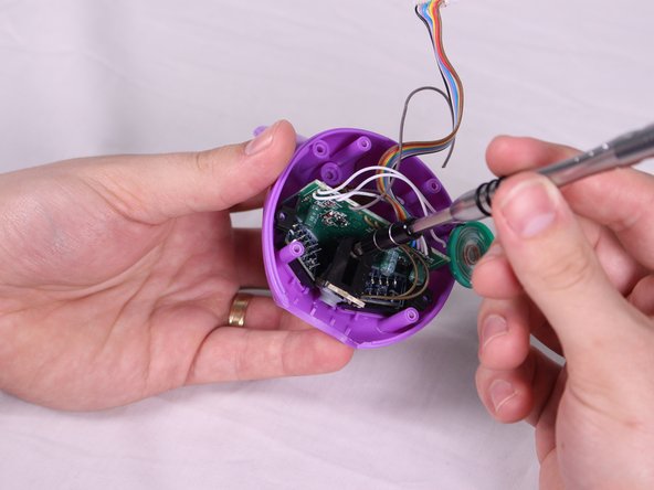

  13. Zoomer Meowzies Eyes/Motherboard Replacement: crwdns2935265:013crwdnd2935265:01crwdnd2935265:03crwdne2935265:0 Zoomer Meowzies Eyes/Motherboard Replacement: crwdns2935265:013crwdnd2935265:02crwdnd2935265:03crwdne2935265:0 Zoomer Meowzies Eyes/Motherboard Replacement: crwdns2935265:013crwdnd2935265:03crwdnd2935265:03crwdne2935265:0
    • Using the Phillips #1 driver, remove the 7.0mm screw holding the contact in place.
    • Pulling lightly on the contact, remove it and its brace from the motherboard.

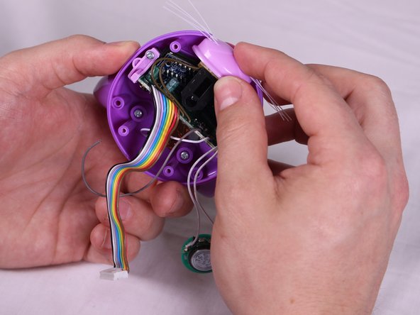

  14. Zoomer Meowzies Eyes/Motherboard Replacement: crwdns2935265:014crwdnd2935265:01crwdnd2935265:03crwdne2935265:0 Zoomer Meowzies Eyes/Motherboard Replacement: crwdns2935265:014crwdnd2935265:02crwdnd2935265:03crwdne2935265:0 Zoomer Meowzies Eyes/Motherboard Replacement: crwdns2935265:014crwdnd2935265:03crwdnd2935265:03crwdne2935265:0
    • With the head in hand, place thumbs on the screens and press gently inside and upwards to lift the screen and motherboard out from the head.
