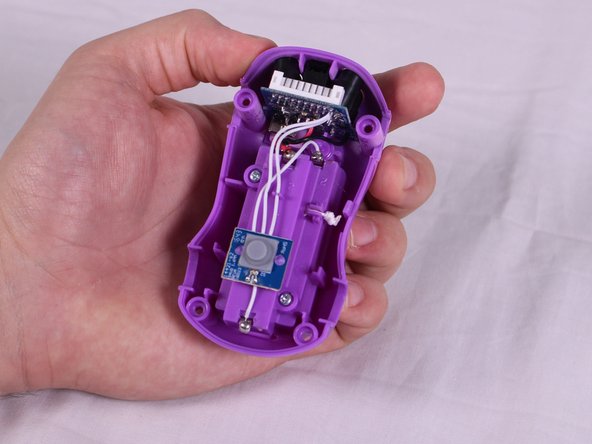

    • Turn the device so that the the device is on its side.
    • Hold the back and belly on the device and gently pull apart.
    • Pulling with too much force might damage a few cables inside, so caution is needed.

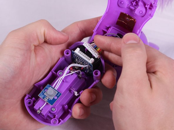

  3. Zoomer Meowzies Chest Senor Replacement: crwdns2935265:03crwdnd2935265:01crwdnd2935265:03crwdne2935265:0 Zoomer Meowzies Chest Senor Replacement: crwdns2935265:03crwdnd2935265:02crwdnd2935265:03crwdne2935265:0 Zoomer Meowzies Chest Senor Replacement: crwdns2935265:03crwdnd2935265:03crwdnd2935265:03crwdne2935265:0
    • With insides exposed, grab leg and gently pull up and away from the body to detach them. Repeat for all legs needed.

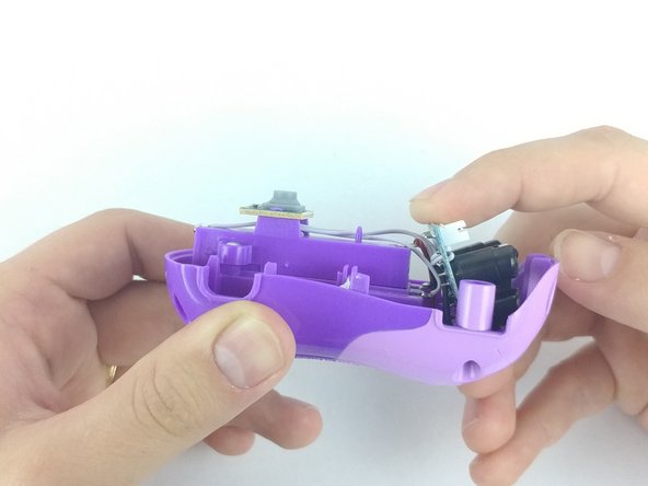

  4. Zoomer Meowzies Chest Senor Replacement, Chest Senor: crwdns2935265:04crwdnd2935265:01crwdnd2935265:03crwdne2935265:0 Zoomer Meowzies Chest Senor Replacement, Chest Senor: crwdns2935265:04crwdnd2935265:02crwdnd2935265:03crwdne2935265:0 Zoomer Meowzies Chest Senor Replacement, Chest Senor: crwdns2935265:04crwdnd2935265:03crwdnd2935265:03crwdne2935265:0
    • Carefully pry the ribbon cable from the connector.
    • Though we find it easier to use our fingers, the pry-tools may be useful.

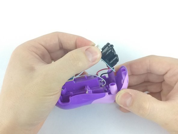

    • For easier access to the sensor, tilt and pull the sensor away from the body.

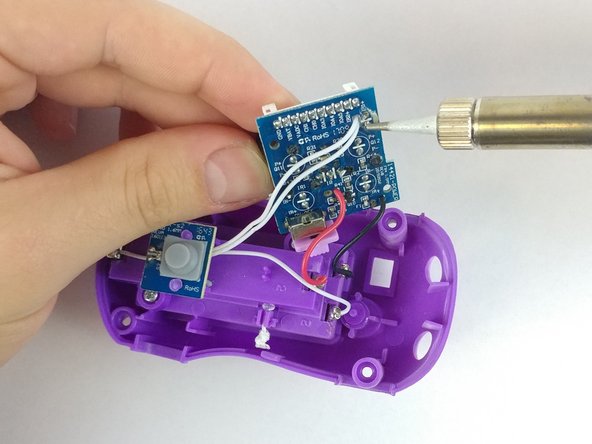

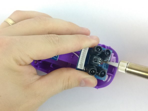

  6. Zoomer Meowzies Chest Senor Replacement: crwdns2935265:06crwdnd2935265:01crwdnd2935265:03crwdne2935265:0 Zoomer Meowzies Chest Senor Replacement: crwdns2935265:06crwdnd2935265:02crwdnd2935265:03crwdne2935265:0 Zoomer Meowzies Chest Senor Replacement: crwdns2935265:06crwdnd2935265:03crwdnd2935265:03crwdne2935265:0
    • To remove the sensors, use a soldering iron to solder the two points and remove the red and black wires from the reverse side.
    • The soldering iron is very hot, so take caution not to touch it directly in order to avoid burns.

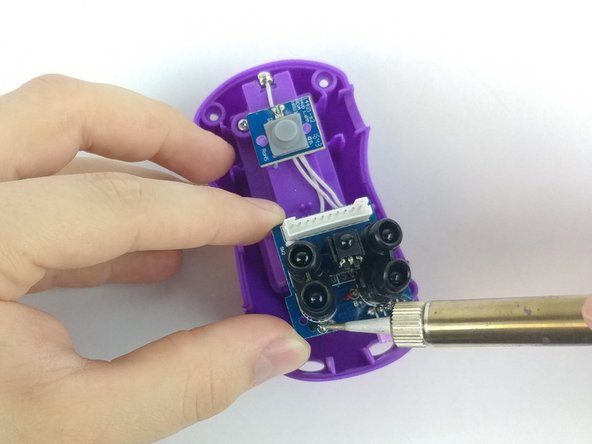

  7. Zoomer Meowzies Chest Senor Replacement: crwdns2935265:07crwdnd2935265:01crwdnd2935265:02crwdne2935265:0 Zoomer Meowzies Chest Senor Replacement: crwdns2935265:07crwdnd2935265:02crwdnd2935265:02crwdne2935265:0
    • Turn the sensors over and locate the solder points of the remaining white wires. Heat the solder and remove the pair of wires.
    • The sensor should be completely detachable now.
