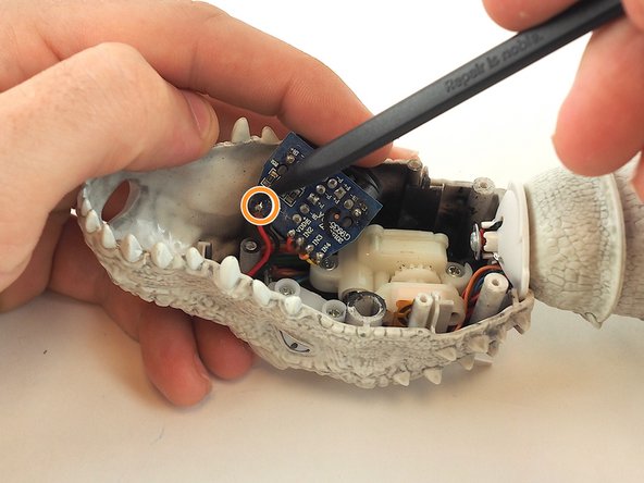

  3. Zoomer Jurassic World Indominus Rex Nose Sensors Replacement, Nose Sensors: crwdns2935265:03crwdnd2935265:01crwdnd2935265:02crwdne2935265:0 Zoomer Jurassic World Indominus Rex Nose Sensors Replacement, Nose Sensors: crwdns2935265:03crwdnd2935265:02crwdnd2935265:02crwdne2935265:0
    • Carefully, pull out the circuit board that has the three nose sensors attached.
    • You're almost done! The only thing left to do is to use a soldering iron to remove the six (6) wires connected to the circuit board.
    • Use caution when soldering to avoid being burned.
