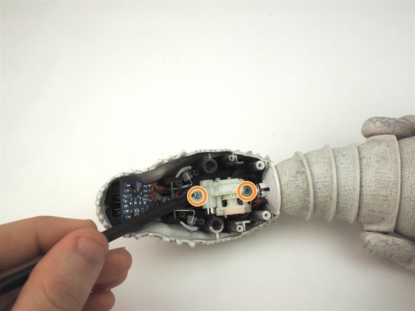

  2. Zoomer Jurassic World Indominus Rex Mouth Gears Replacement: crwdns2935265:02crwdnd2935265:01crwdnd2935265:03crwdne2935265:0 Zoomer Jurassic World Indominus Rex Mouth Gears Replacement: crwdns2935265:02crwdnd2935265:02crwdnd2935265:03crwdne2935265:0 Zoomer Jurassic World Indominus Rex Mouth Gears Replacement: crwdns2935265:02crwdnd2935265:03crwdnd2935265:03crwdne2935265:0
    • Remove the 7.5mm phillips screw using Phillips #1 screwdriver from the middle of the tongue.
    • Using a spudger, gently pry the tongue out of the mouth.

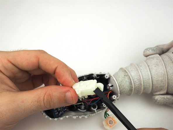

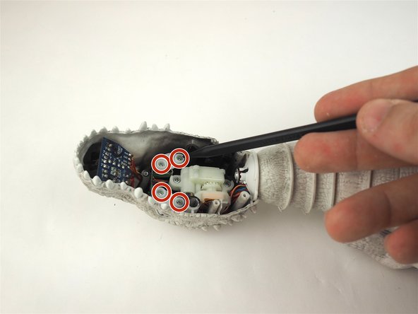

  3. Zoomer Jurassic World Indominus Rex Mouth Gears Replacement, Mouth Gears: crwdns2935265:03crwdnd2935265:01crwdnd2935265:03crwdne2935265:0 Zoomer Jurassic World Indominus Rex Mouth Gears Replacement, Mouth Gears: crwdns2935265:03crwdnd2935265:02crwdnd2935265:03crwdne2935265:0 Zoomer Jurassic World Indominus Rex Mouth Gears Replacement, Mouth Gears: crwdns2935265:03crwdnd2935265:03crwdnd2935265:03crwdne2935265:0
    • After removing the tongue, inspect and remove any debris from the inside of the mouth.
    • Remove the four (4) 7.5mm phillips screws that are inhibiting your ability to successfully remove the motor inside the mouth.
    • Remove the two (2) 7.2mm phillips screws that fasten the motor to the inside of the mouth.

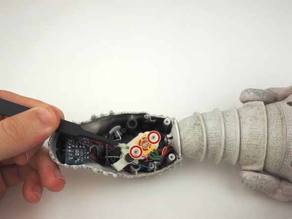

  4. Zoomer Jurassic World Indominus Rex Mouth Gears Replacement: crwdns2935265:04crwdnd2935265:01crwdnd2935265:03crwdne2935265:0 Zoomer Jurassic World Indominus Rex Mouth Gears Replacement: crwdns2935265:04crwdnd2935265:02crwdnd2935265:03crwdne2935265:0 Zoomer Jurassic World Indominus Rex Mouth Gears Replacement: crwdns2935265:04crwdnd2935265:03crwdnd2935265:03crwdne2935265:0
    • Use a pair of tweezers to remove the motor assembly from the mouth and inspect for any apparent issues.
    • Use a #1 Phillips Screwdriver to remove the two (2) 5.5mm phillips screws to remove the motor from the rest of the assembly.
    • Use tweezers to gently remove the motor from the rest of the assembly.

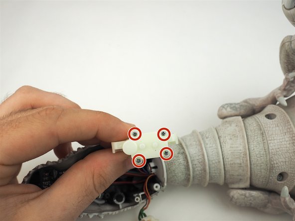

  5. Zoomer Jurassic World Indominus Rex Mouth Gears Replacement: crwdns2935265:05crwdnd2935265:01crwdnd2935265:03crwdne2935265:0 Zoomer Jurassic World Indominus Rex Mouth Gears Replacement: crwdns2935265:05crwdnd2935265:02crwdnd2935265:03crwdne2935265:0 Zoomer Jurassic World Indominus Rex Mouth Gears Replacement: crwdns2935265:05crwdnd2935265:03crwdnd2935265:03crwdne2935265:0
    • Use tweezers, inspect the main output gear for the jaw and remove if necessary.
    • Remove the four (4) 4.9mm screws from the other side of the assembly.
    • Use a spudger to gently pry apart the assembly for inspection.

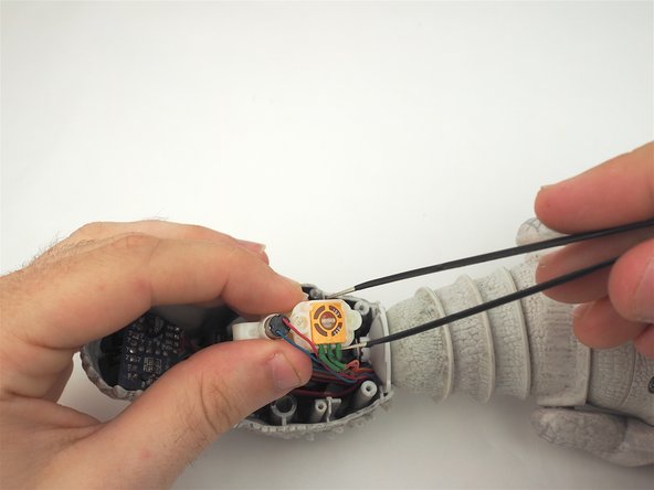

  6. Zoomer Jurassic World Indominus Rex Mouth Gears Replacement: crwdns2935265:06crwdnd2935265:01crwdnd2935265:01crwdne2935265:0
    • Inspect the gears inside the assembly and replace any gears that have flattened or rounded teeth.
