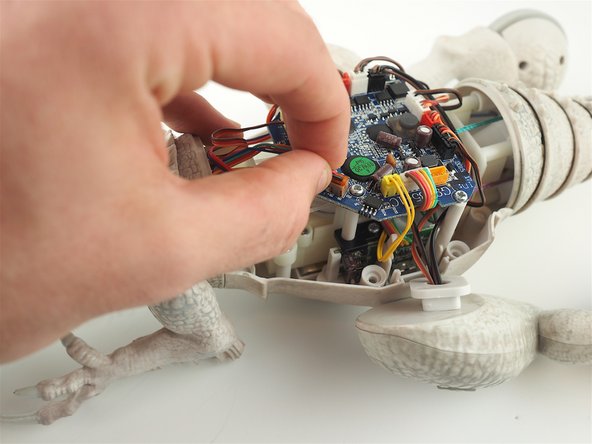

  4. Zoomer Jurassic World Indominus Rex Motherboard Replacement, Motherboard: crwdns2935265:04crwdnd2935265:01crwdnd2935265:02crwdne2935265:0 Zoomer Jurassic World Indominus Rex Motherboard Replacement, Motherboard: crwdns2935265:04crwdnd2935265:02crwdnd2935265:02crwdne2935265:0
    • Let the toy rest firmly on a flat surface before processing to the next step.
    • Gently pull each wire out of the connector on the motherboard. Use a set of tweezers, if necessary.

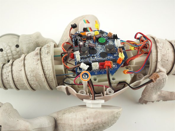

  5. Zoomer Jurassic World Indominus Rex Motherboard Replacement: crwdns2935265:05crwdnd2935265:01crwdnd2935265:02crwdne2935265:0 Zoomer Jurassic World Indominus Rex Motherboard Replacement: crwdns2935265:05crwdnd2935265:02crwdnd2935265:02crwdne2935265:0
    • Remove the two (2) #0 7.5mm phillips screws from the left side of the motherboard.
    • Remove the one (1) 7.5mm #0 phillips screw from the right side of the motherboard.
