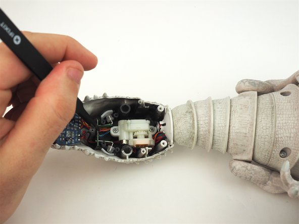

  3. Zoomer Jurassic World Indominus Rex Eye LED Replacement, Eye LED: crwdns2935265:03crwdnd2935265:01crwdnd2935265:02crwdne2935265:0 Zoomer Jurassic World Indominus Rex Eye LED Replacement, Eye LED: crwdns2935265:03crwdnd2935265:02crwdnd2935265:02crwdne2935265:0
    • Remove the four (4) 7.5mm Phillips screws from the pieces holding the circuit board for the LEDs in place.
    • Use tweezers to pull the circuit board out of place.
    • Pull directly upward! Be careful not to break the circuit board during removal.
  4. Zoomer Jurassic World Indominus Rex Eye LED Replacement: crwdns2935265:04crwdnd2935265:01crwdnd2935265:01crwdne2935265:0
    • Use a soldering iron to disconnect the four (4) wires from the circuit board.
    • Soldering technique guide from iFixit can be found here.
    • Be careful not to burn yourself or the plastic while soldering!
