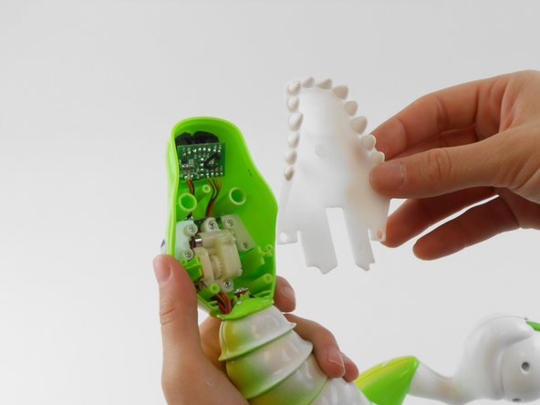

    • Use the spudger to pry Zoomer Dino Boomer's lower jaw from its mouth.
  3. Zoomer Dino Boomer Nose Sensor Replacement: crwdns2935265:03crwdnd2935265:01crwdnd2935265:02crwdne2935265:0 Zoomer Dino Boomer Nose Sensor Replacement: crwdns2935265:03crwdnd2935265:02crwdnd2935265:02crwdne2935265:0
    • Remove the roof of Zoomer Dino Boomer's mouth by unscrewing the 7.5 mm Phillips #0 screw.

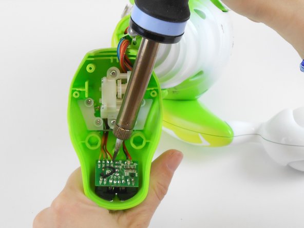

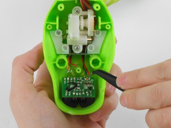

  5. Zoomer Dino Boomer Nose Sensor Replacement: crwdns2935265:05crwdnd2935265:01crwdnd2935265:03crwdne2935265:0 Zoomer Dino Boomer Nose Sensor Replacement: crwdns2935265:05crwdnd2935265:02crwdnd2935265:03crwdne2935265:0 Zoomer Dino Boomer Nose Sensor Replacement: crwdns2935265:05crwdnd2935265:03crwdnd2935265:03crwdne2935265:0
    • Use a soldering iron to remove the wires from the sensor chip by melting the metal joints on the chip.
    • Use the tweezers to remove the wires as you are soldering them.
    • Do not touch any parts of Zoomer Dino Boomer or yourself when using the soldering iron. The soldering iron will be very hot.
    • When reassembling, extra solder may be required to reconnect the wires with the circuit board.
  6. Zoomer Dino Boomer Nose Sensor Replacement: crwdns2935265:06crwdnd2935265:01crwdnd2935265:01crwdne2935265:0
    • Remove and replace the nose sensor.
