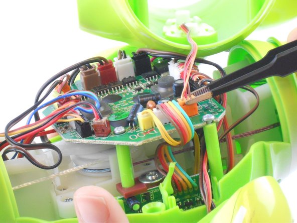

  3. Zoomer Dino Boomer Main Circuit Board Replacement: crwdns2935265:03crwdnd2935265:01crwdnd2935265:03crwdne2935265:0 Zoomer Dino Boomer Main Circuit Board Replacement: crwdns2935265:03crwdnd2935265:02crwdnd2935265:03crwdne2935265:0 Zoomer Dino Boomer Main Circuit Board Replacement: crwdns2935265:03crwdnd2935265:03crwdnd2935265:03crwdne2935265:0
    • Disconnect the wire that connects the back cover of the dino to the main circuit board by carefully pulling on the orange wire connector with tweezers.
    • Remove back cover.
    • If you are having difficulty removing the connector from its socket, push in the small tabs on the side of the connector with the tweezers. This step may take some work.
    • Do not damage the wires or circuit board.

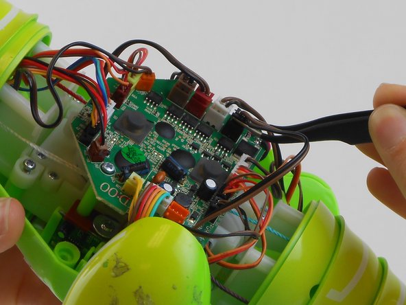

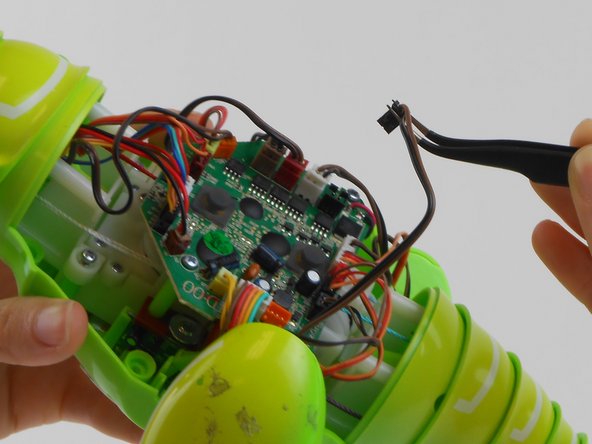

  4. Zoomer Dino Boomer Main Circuit Board Replacement, Main Circuit Board: crwdns2935265:04crwdnd2935265:01crwdnd2935265:03crwdne2935265:0 Zoomer Dino Boomer Main Circuit Board Replacement, Main Circuit Board: crwdns2935265:04crwdnd2935265:02crwdnd2935265:03crwdne2935265:0 Zoomer Dino Boomer Main Circuit Board Replacement, Main Circuit Board: crwdns2935265:04crwdnd2935265:03crwdnd2935265:03crwdne2935265:0
    • Use tweezers to remove all of the colored wire connectors from their sockets on the circuit board.

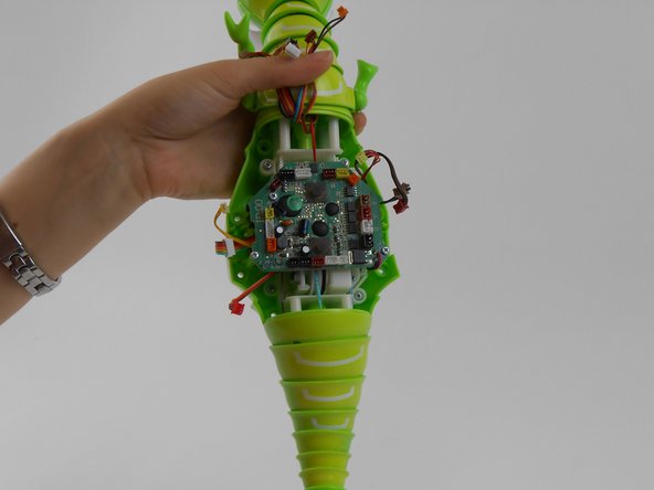

  5. Zoomer Dino Boomer Main Circuit Board Replacement: crwdns2935265:05crwdnd2935265:01crwdnd2935265:02crwdne2935265:0 Zoomer Dino Boomer Main Circuit Board Replacement: crwdns2935265:05crwdnd2935265:02crwdnd2935265:02crwdne2935265:0
    • Remove legs.
  6. Zoomer Dino Boomer Main Circuit Board Replacement: crwdns2935265:06crwdnd2935265:01crwdnd2935265:01crwdne2935265:0
    • Remove the three 7.2 mm Phillips #0 screws connecting the main circuit board to the body of Zoomer Dino Boomer.

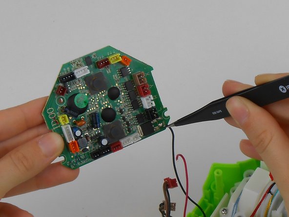

  7. Zoomer Dino Boomer Main Circuit Board Replacement: crwdns2935265:07crwdnd2935265:01crwdnd2935265:03crwdne2935265:0 Zoomer Dino Boomer Main Circuit Board Replacement: crwdns2935265:07crwdnd2935265:02crwdnd2935265:03crwdne2935265:0 Zoomer Dino Boomer Main Circuit Board Replacement: crwdns2935265:07crwdnd2935265:03crwdnd2935265:03crwdne2935265:0
    • Use soldering iron and tweezers to disconnect main circuit board from the black and red wires.
    • Check out iFixit's soldering techniques guide to learn more about soldering and desoldering connections.
    • Remove main circuit board from Zoomer Dino Boomer
