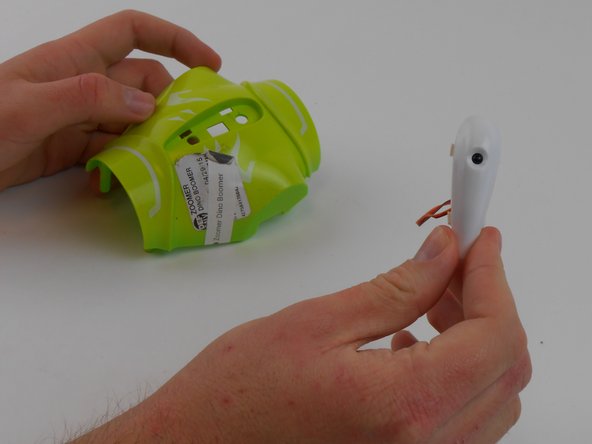

  4. Zoomer Dino Boomer Back Button Replacement, Back Button: crwdns2935265:04crwdnd2935265:01crwdnd2935265:01crwdne2935265:0
    • Where the button is largest, squeeze the two white tabs together.
  5. Zoomer Dino Boomer Back Button Replacement: crwdns2935265:05crwdnd2935265:01crwdnd2935265:01crwdne2935265:0
    • Push in the white circular piece between these tabs as far as it will go.
  6. Zoomer Dino Boomer Back Button Replacement: crwdns2935265:06crwdnd2935265:01crwdnd2935265:02crwdne2935265:0 Zoomer Dino Boomer Back Button Replacement: crwdns2935265:06crwdnd2935265:02crwdnd2935265:02crwdne2935265:0
    • Where the button is smallest, squeeze the two white tabs together and press the circular tab in-between them until the button comes loose.
    • Remove the back button.
