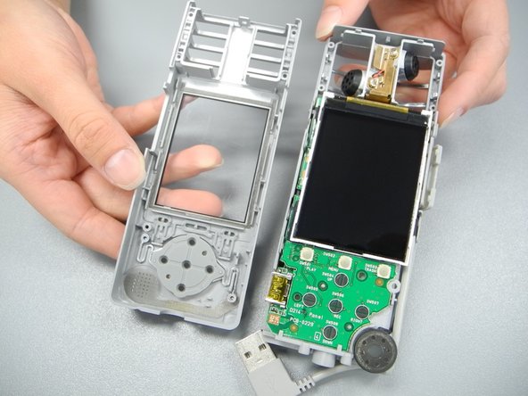

      • WARNING: Pieces may become loose when you separate the device in half!
      • Run the pry tool along the edges of the device to begin separating the device in two halves.
    7. Zoom Q3HD Handy Video Recorder Lens Cleaning: crwdns2935265:07crwdnd2935265:01crwdnd2935265:02crwdne2935265:0 Zoom Q3HD Handy Video Recorder Lens Cleaning: crwdns2935265:07crwdnd2935265:02crwdnd2935265:02crwdne2935265:0
      • REMINDER: Pieces may become loose when you separate the device in half!
      • Apply upward pressure to fully separate the device into two halves.
    8. Zoom Q3HD Handy Video Recorder Lens Cleaning: crwdns2935265:08crwdnd2935265:01crwdnd2935265:01crwdne2935265:0
      • WARNING: If you’re not careful with keeping the screen close to the board, you will rip off the ribbon attaching the screen to the circuit board.
      • Lift display screen keeping the top half close to the board.
    9. Zoom Q3HD Handy Video Recorder Lens Cleaning: crwdns2935265:09crwdnd2935265:01crwdnd2935265:01crwdne2935265:0
      • Gently flip the black clip up attaching the ribbon of the screen to the circuit board.
    10. Zoom Q3HD Handy Video Recorder Lens Cleaning: crwdns2935265:010crwdnd2935265:01crwdnd2935265:01crwdne2935265:0
      • Gently slide the ribbon from the circuit board, removing the screen.
