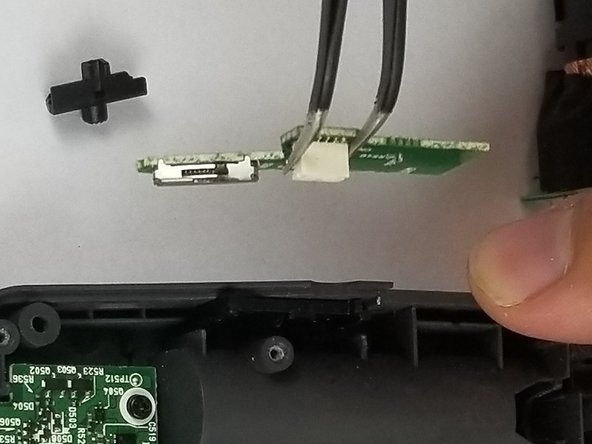

  12. Zoom H6 Handy Recorder Power Switch Replacement, Power Switch: crwdns2935265:012crwdnd2935265:01crwdnd2935265:03crwdne2935265:0 Zoom H6 Handy Recorder Power Switch Replacement, Power Switch: crwdns2935265:012crwdnd2935265:02crwdnd2935265:03crwdne2935265:0 Zoom H6 Handy Recorder Power Switch Replacement, Power Switch: crwdns2935265:012crwdnd2935265:03crwdnd2935265:03crwdne2935265:0
    • Use tweezers to lift the power switch out and set aside.
  13. Zoom H6 Handy Recorder Power Switch Replacement: crwdns2935265:013crwdnd2935265:01crwdnd2935265:03crwdne2935265:0 Zoom H6 Handy Recorder Power Switch Replacement: crwdns2935265:013crwdnd2935265:02crwdnd2935265:03crwdne2935265:0 Zoom H6 Handy Recorder Power Switch Replacement: crwdns2935265:013crwdnd2935265:03crwdnd2935265:03crwdne2935265:0
    • Use tweezers to lift power switch circuit out of device by the plastic ribbon connection.
    • Replace the power switch circuit.
    • Don't touch the metal part of the circuit with the tweezers
