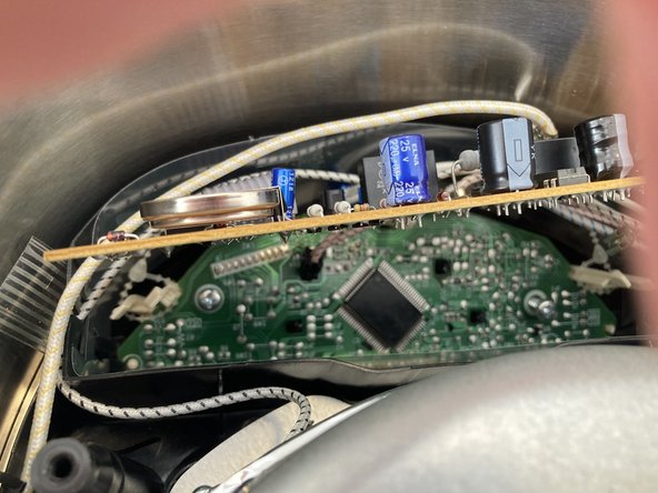

  3. Zojirushi Rice Cooker Model NS-LAC05  Battery Replacement, Fold Out Top Circuit Board: crwdns2935265:03crwdnd2935265:01crwdnd2935265:02crwdne2935265:0 Zojirushi Rice Cooker Model NS-LAC05  Battery Replacement, Fold Out Top Circuit Board: crwdns2935265:03crwdnd2935265:02crwdnd2935265:02crwdne2935265:0
    • You can now see the circuit board with battery.
    • There are actually two circuit boards stacked on top of each other. You can leave the hidden circuit board (with the display and controls) in place for this repair.
    • Remove 6 connectors from the top circuit board. Pull these straight out. there are no locking mechanisms. From left to right they are Red, Black, Yellow, Blue, Blue base and Black base. The colors are nicely marked on the circuit board.
    • The ribbon cable does not have a connector, so don't remove it, leave it in place.
    • Push in the plastic tabs holding the top board in place to release it, and fold it out on the ribbon cable to expose the underside of the clock battery.
    • Don't remove the bottom board! I did this and it was a big pain to get it correctly reseated so that the control buttons worked.

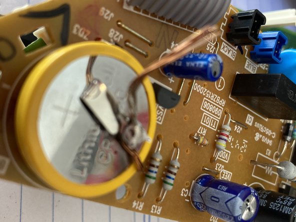

  4. Zojirushi Rice Cooker Model NS-LAC05  Battery Replacement, Unsolder the old battery: crwdns2935265:04crwdnd2935265:01crwdnd2935265:01crwdne2935265:0
    • Use your soldering iron to heat one of the two battery terminals on the back-side of the top circuit board. The terminals are conveniently marked.
    • When the solder is melted use your plastic spudger to pry the battery away from the top of the circuit board.
    • Repeat for the other battery terminal and remove the battery for recycling.
    • Caution! If you want pull the battery away with pliers, wrap the pliers with electrical tape to avoid shorting out the battery. You can probably use your fingers (if not too hot) or your plastic spudger.
  5. Zojirushi Rice Cooker Model NS-LAC05  Battery Replacement, Solder in new battery: crwdns2935265:05crwdnd2935265:01crwdnd2935265:02crwdne2935265:0 Zojirushi Rice Cooker Model NS-LAC05  Battery Replacement, Solder in new battery: crwdns2935265:05crwdnd2935265:02crwdnd2935265:02crwdne2935265:0
    • Hopefully you bought a replacement battery with Solder tabs. I found mine on eBay.
    • The solder tabs on your replacement battery may not line up with where you need them, mine didn't.
    • I soldered one tab in place directly, then soldered some stranded wire to bridge between the second tab and the circuit board. I trimmed and bent the second tab a little to make this work. It was easy to solder the wire to.
    • Read the comments...some people smarter than me have soldered in battery holders to make changing the battery easier in the future. Genius!

@Ed Chao - good comments on the security screw and the battery holder. That’s probably an easier fix then soldering in a battery with tabs. Jim J
Jimjar - crwdns2934203:0crwdne2934203:0
Thanks for the article. I fixed mine by removing the battery and adding wire leads to a 2032 battery holder. I covered the connections on the back of the holder with epoxy to insulate the leads. I then hot glued the holder to the inside front of the case. I still have to remove bottom to replace battery, but 2032 batteries are cheaper and easier to find. I replaced the security screw with a standard one.
