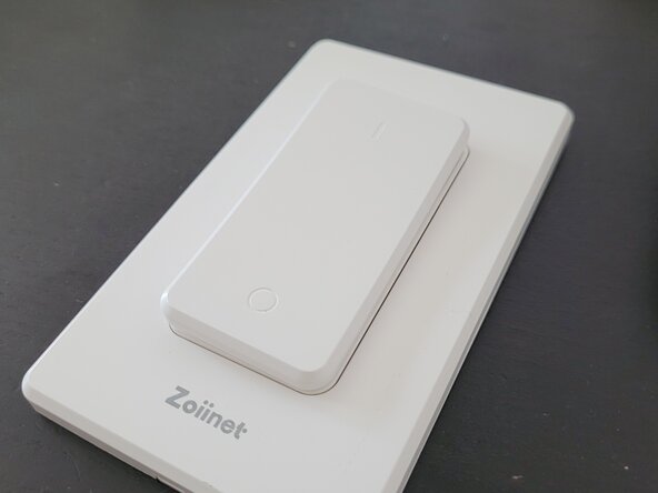

Zoiinet AK1 Smart Switch Battery Replacement

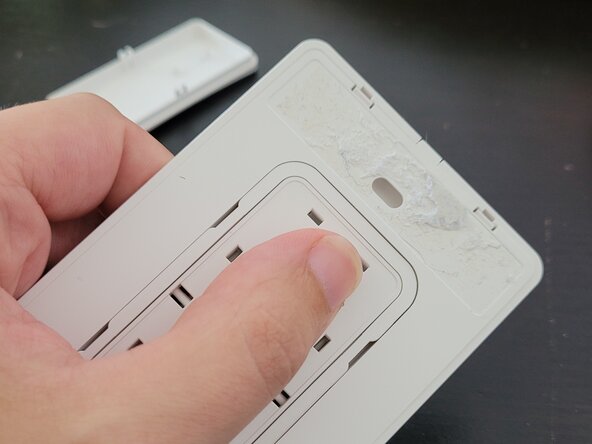

    • Dislodge the switch mounting plate from the wall (if applicable -- you may have adhesive on the back or basic screws)
  2. Zoiinet AK1 Smart Switch Battery Replacement, Eject the Rocker Switch: crwdns2935265:02crwdnd2935265:01crwdnd2935265:01crwdne2935265:0
    • Gently press on the rocker switch from the back of the plate, it should easily pop out.
