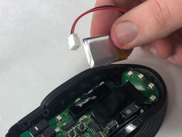

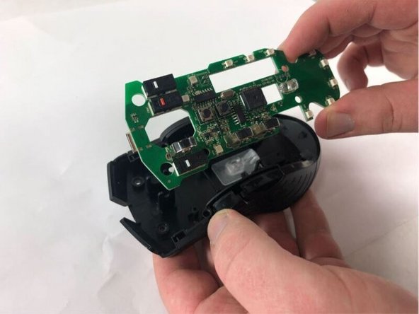

  6. Zerodate T26 USB-C Port Replacement, USB-C Port: crwdns2935265:06crwdnd2935265:01crwdnd2935265:03crwdne2935265:0 Zerodate T26 USB-C Port Replacement, USB-C Port: crwdns2935265:06crwdnd2935265:02crwdnd2935265:03crwdne2935265:0 Zerodate T26 USB-C Port Replacement, USB-C Port: crwdns2935265:06crwdnd2935265:03crwdnd2935265:03crwdne2935265:0
    • Take out the battery obstructing movement. This should now allow you to gently pull the circuit board up from the bottom of the mouse.
    • Please be very careful when pulling up the circuit board! Yanking it out could result in further damage to the mouse. Make sure you go slow and steady!
  7. Zerodate T26 USB-C Port Replacement: crwdns2935265:07crwdnd2935265:01crwdnd2935265:01crwdne2935265:0
    • De-solder the charging port at one end of the mouse, in order to carefully remove it for a replacement.
    • Please be sure to review safety guidelines and guided steps on soldering before attempting to remove any circuitry. In order to keep yourself safe and your mouse undamaged, please follow the guide found here to learn to properly solder.
