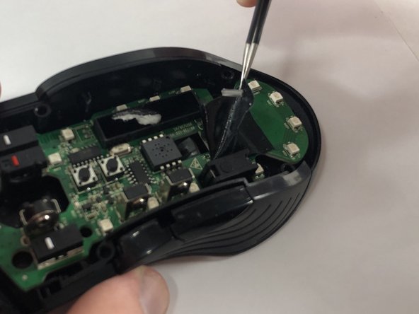

    • Remove the scroll wheel by pushing it to the right and pulling up.
  6. Zerodate T26 RGB LED Replacement, RGB LED: crwdns2935265:06crwdnd2935265:01crwdnd2935265:03crwdne2935265:0 Zerodate T26 RGB LED Replacement, RGB LED: crwdns2935265:06crwdnd2935265:02crwdnd2935265:03crwdne2935265:0 Zerodate T26 RGB LED Replacement, RGB LED: crwdns2935265:06crwdnd2935265:03crwdnd2935265:03crwdne2935265:0

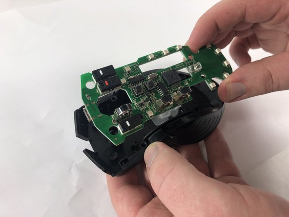

    • Disconnect the battery from the circuit board.
    • Use the precision tweezers to remove the tape from the circuit board.
    • Carefully pull apart the circuit board from the bottom shell.
  7. Zerodate T26 RGB LED Replacement: crwdns2935265:07crwdnd2935265:01crwdnd2935265:01crwdne2935265:0
    • Desolder the LEDs from the circuit board and solder on the new LEDs following the soldering guide.
    • Please be sure to review safety guidelines and guided steps on soldering/desoldering before attempting remove of LEDs
