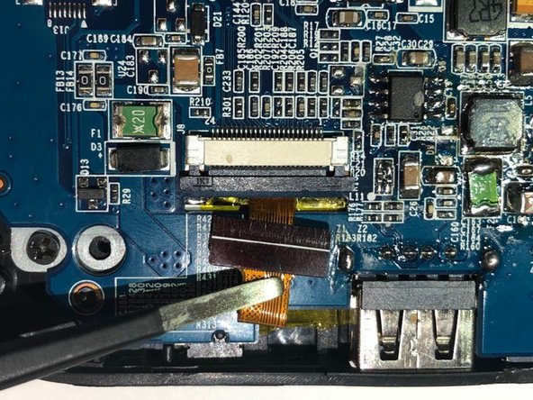

  8. Zenithink ZTPAD ZT280 C91 Camera Replacement: crwdns2935265:08crwdnd2935265:01crwdnd2935265:01crwdne2935265:0
    • Peel back the reflective tape.

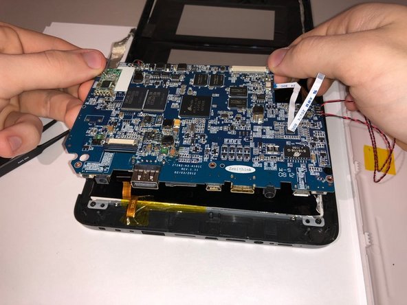

  9. Zenithink ZTPAD ZT280 C91 Camera Replacement: crwdns2935265:09crwdnd2935265:01crwdnd2935265:02crwdne2935265:0 Zenithink ZTPAD ZT280 C91 Camera Replacement: crwdns2935265:09crwdnd2935265:02crwdnd2935265:02crwdne2935265:0
    • Lift up the motherboard assembly, starting by lifting up the top.
    • Be careful not to damage any of the ports on the underside of the tablet.
    • The camera cable will slide through a small notch and end up underneath the board.
