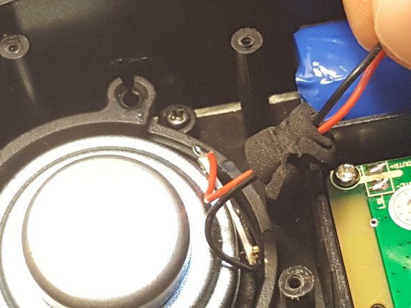

  5. Zenbre SoundBank Z3 Speaker Replacement, Speakers: crwdns2935265:05crwdnd2935265:01crwdnd2935265:02crwdne2935265:0 Zenbre SoundBank Z3 Speaker Replacement, Speakers: crwdns2935265:05crwdnd2935265:02crwdnd2935265:02crwdne2935265:0
    • Remove the three screws that are holding the speaker down.
    • Be careful not to rip out the speaker while taking out the screws.
  6. Zenbre SoundBank Z3 Speaker Replacement: crwdns2935265:06crwdnd2935265:01crwdnd2935265:02crwdne2935265:0 Zenbre SoundBank Z3 Speaker Replacement: crwdns2935265:06crwdnd2935265:02crwdnd2935265:02crwdne2935265:0
    • Desolder the speaker joints from the motherboard. Follow this How To Solder guide for help with desoldering.
  7. Zenbre SoundBank Z3 Speaker Replacement: crwdns2935265:07crwdnd2935265:01crwdnd2935265:02crwdne2935265:0 Zenbre SoundBank Z3 Speaker Replacement: crwdns2935265:07crwdnd2935265:02crwdnd2935265:02crwdne2935265:0
    • Remove the speaker from the motherboard.
    • Remove the speaker ring.
    • Be careful not to remove other components in the speaker.
    • Repeat Steps 5-7 with the other speaker.
