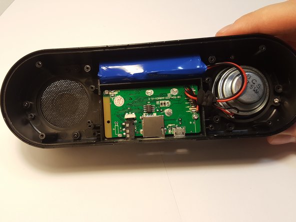

    • Remove the bottom panel speaker using an iFixit opening tool.
  4. Zenbre SoundBank Z3 Speaker Grill Replacement, Motherboard Cover: crwdns2935265:04crwdnd2935265:01crwdnd2935265:03crwdne2935265:0 Zenbre SoundBank Z3 Speaker Grill Replacement, Motherboard Cover: crwdns2935265:04crwdnd2935265:02crwdnd2935265:03crwdne2935265:0 Zenbre SoundBank Z3 Speaker Grill Replacement, Motherboard Cover: crwdns2935265:04crwdnd2935265:03crwdnd2935265:03crwdne2935265:0
    • Remove the four 4.5 mm silver Phillips screws that secure the plastic panel covering the motherboard.
    • Remove the plastic panel.
  5. Zenbre SoundBank Z3 Speaker Grill Replacement, Speaker Grill: crwdns2935265:05crwdnd2935265:01crwdnd2935265:03crwdne2935265:0 Zenbre SoundBank Z3 Speaker Grill Replacement, Speaker Grill: crwdns2935265:05crwdnd2935265:02crwdnd2935265:03crwdne2935265:0 Zenbre SoundBank Z3 Speaker Grill Replacement, Speaker Grill: crwdns2935265:05crwdnd2935265:03crwdnd2935265:03crwdne2935265:0

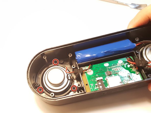

    • Remove the three silver Phillips screws from the plastic ring that holds the speaker in place.
    • Be careful not to rip out the speaker while taking out the screws
    • The same steps can be done on the other side of the speaker
  6. Zenbre SoundBank Z3 Speaker Grill Replacement: crwdns2935265:06crwdnd2935265:01crwdnd2935265:03crwdne2935265:0 Zenbre SoundBank Z3 Speaker Grill Replacement: crwdns2935265:06crwdnd2935265:02crwdnd2935265:03crwdne2935265:0 Zenbre SoundBank Z3 Speaker Grill Replacement: crwdns2935265:06crwdnd2935265:03crwdnd2935265:03crwdne2935265:0

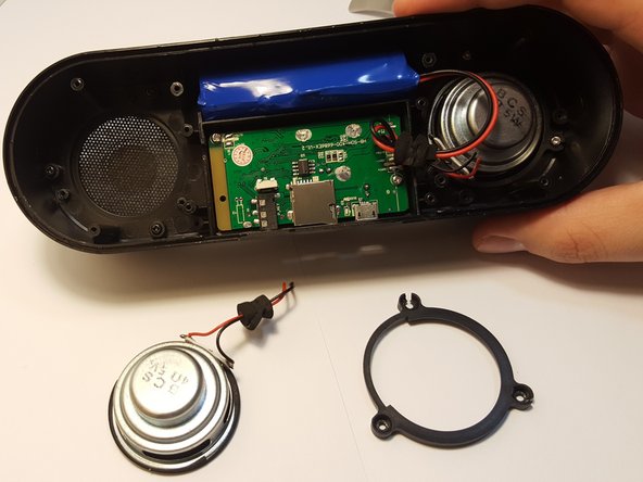

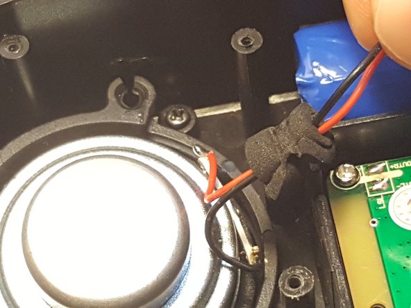

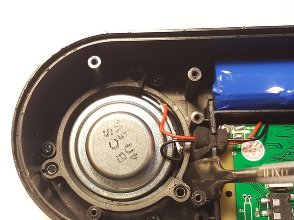

    • First, remove the speaker from the motherboard, then remove the ring that held the speaker in place.
    • These are the joints that need to be soldered. Follow this guide link to help you remove the wires from the motherboard.
    • How To Solder and Desolder Connections
  7. Zenbre SoundBank Z3 Speaker Grill Replacement: crwdns2935265:07crwdnd2935265:01crwdnd2935265:02crwdne2935265:0 Zenbre SoundBank Z3 Speaker Grill Replacement: crwdns2935265:07crwdnd2935265:02crwdnd2935265:02crwdne2935265:0
    • With the plastic ring removed, the speaker should slide out easily.
    • Be careful not remove other components in the speaker

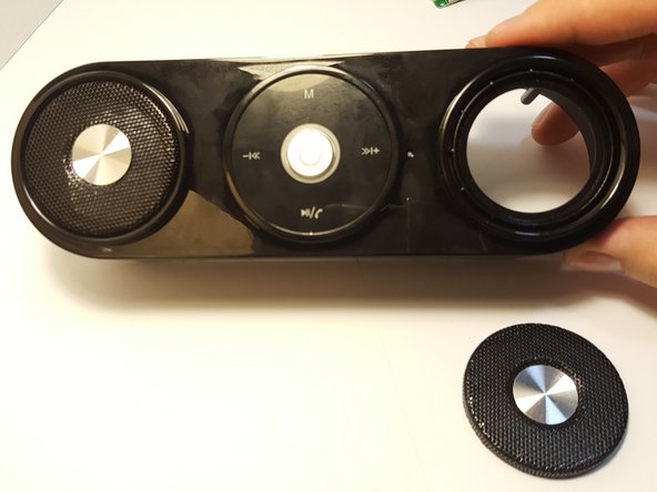

    • This will expose the speaker grill
  8. Zenbre SoundBank Z3 Speaker Grill Replacement: crwdns2935265:08crwdnd2935265:01crwdnd2935265:03crwdne2935265:0 Zenbre SoundBank Z3 Speaker Grill Replacement: crwdns2935265:08crwdnd2935265:02crwdnd2935265:03crwdne2935265:0 Zenbre SoundBank Z3 Speaker Grill Replacement: crwdns2935265:08crwdnd2935265:03crwdnd2935265:03crwdne2935265:0

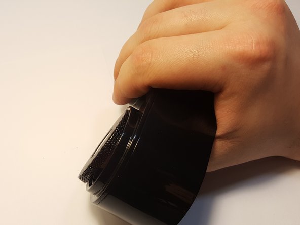

    • Now that the speaker has been removed, the plastic grill should be visible.
    • With a little bit of force they can be pushed out.
