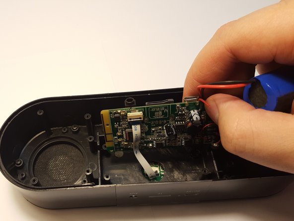

    • Remove the battery from the holder. It may be difficult the first time.
    • Use a spudger between the battery and speaker wall to loosen it from its surroundings.
    • If the battery is punctured, leaking, or bloated/puffy, it may be hazardous and should be properly disposed of.

    • Using a soldering iron, remove the leads, separating the battery from motherboard.
    • Follow this guide to help you remove the wires from the motherboard if you are unfamiliar with soldering.

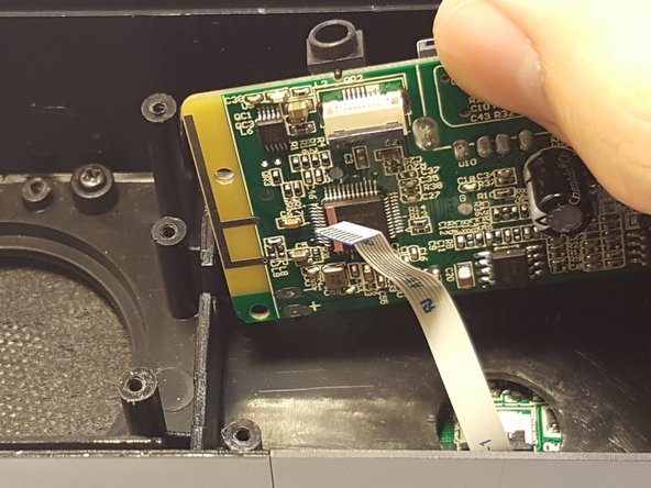

    • Remove the two 4.5 mm Phillips silver screws holding down the motherboard.
    • Note the ribbon that connects the motherboard to the control interface. Be careful with this while removing the motherboard, as it can tear easily.
    • Lift the motherboard out of its housing.
  12. Zenbre SoundBank Z3 Control Interface Circuit Board Replacement: crwdns2935265:012crwdnd2935265:01crwdnd2935265:02crwdne2935265:0 Zenbre SoundBank Z3 Control Interface Circuit Board Replacement: crwdns2935265:012crwdnd2935265:02crwdnd2935265:02crwdne2935265:0
    • Use an iFixit opening tool to lift up the ribbon connector.
    • Slide the ribbon cable out of its connector.

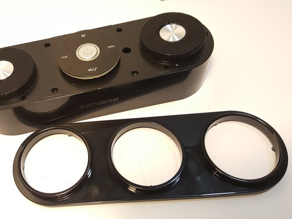

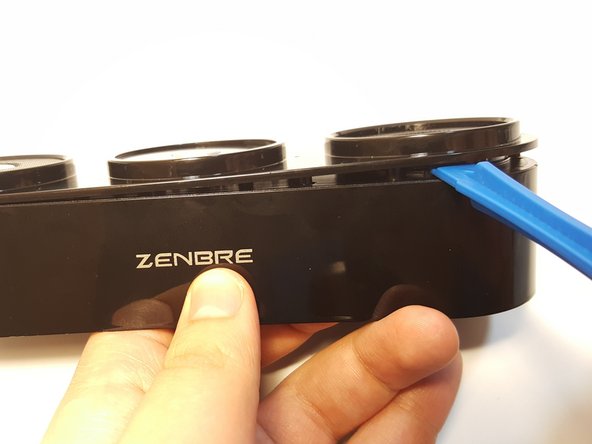

    • Remove the top plastic cover by prying around the edges with an iFixit opening tool.

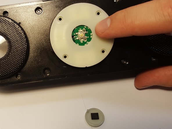

  15. Zenbre SoundBank Z3 Control Interface Circuit Board Replacement: crwdns2935265:015crwdnd2935265:01crwdnd2935265:03crwdne2935265:0 Zenbre SoundBank Z3 Control Interface Circuit Board Replacement: crwdns2935265:015crwdnd2935265:02crwdnd2935265:03crwdne2935265:0 Zenbre SoundBank Z3 Control Interface Circuit Board Replacement: crwdns2935265:015crwdnd2935265:03crwdnd2935265:03crwdne2935265:0

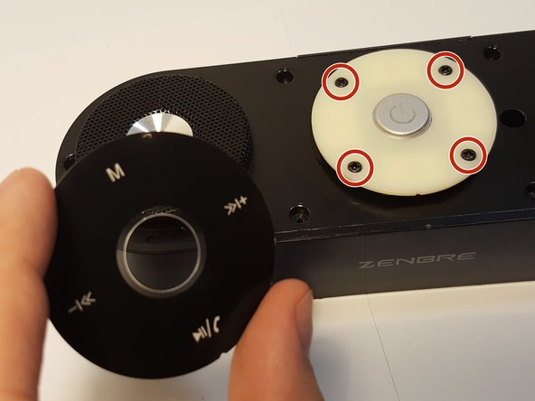

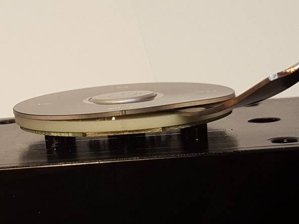

    • Carefully remove the round black cover of the circuit board by using a spudger to pry it upward.
    • When working with electronics, it's important to choose a tool that is electrostatic discharge (ESD) safe in order to avoid accidental damage to the device. A metal spudger is great when you need serious prying power, but a regular black nylon spudger or a plastic tool should be used whenever possible.
    • Handle the cover plate carefully. Just like with the feet from before, it can be replaced if care is used when handling it.
    • Remove the four screws.

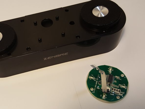

  16. Zenbre SoundBank Z3 Control Interface Circuit Board Replacement: crwdns2935265:016crwdnd2935265:01crwdnd2935265:02crwdne2935265:0 Zenbre SoundBank Z3 Control Interface Circuit Board Replacement: crwdns2935265:016crwdnd2935265:02crwdnd2935265:02crwdne2935265:0

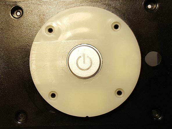

    • Pick up the center power button and remove it. Place it in a safe location.
    • When you pick up the power button, the board will come right off. Be sure not to lose it.
  17. Zenbre SoundBank Z3 Control Interface Circuit Board Replacement: crwdns2935265:017crwdnd2935265:01crwdnd2935265:03crwdne2935265:0 Zenbre SoundBank Z3 Control Interface Circuit Board Replacement: crwdns2935265:017crwdnd2935265:02crwdnd2935265:03crwdne2935265:0 Zenbre SoundBank Z3 Control Interface Circuit Board Replacement: crwdns2935265:017crwdnd2935265:03crwdnd2935265:03crwdne2935265:0
    • Remove these four 7 mm black screws.
    • This will free the circuit board, which can now be lifted away from the housing.
    • If you wish to remove the ribbon here, use the same method used to remove the ribbon from the motherboard earlier in this guide.
