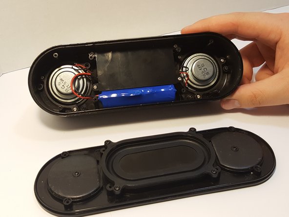

  3. Zenbre SoundBank Z3 Battery Replacement: crwdns2935265:03crwdnd2935265:01crwdnd2935265:02crwdne2935265:0 Zenbre SoundBank Z3 Battery Replacement: crwdns2935265:03crwdnd2935265:02crwdnd2935265:02crwdne2935265:0
    • Remove the bottom panel speaker using an iFixit opening tool.

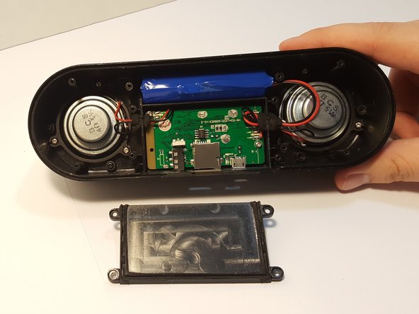

  4. Zenbre SoundBank Z3 Battery Replacement, Motherboard Cover: crwdns2935265:04crwdnd2935265:01crwdnd2935265:03crwdne2935265:0 Zenbre SoundBank Z3 Battery Replacement, Motherboard Cover: crwdns2935265:04crwdnd2935265:02crwdnd2935265:03crwdne2935265:0 Zenbre SoundBank Z3 Battery Replacement, Motherboard Cover: crwdns2935265:04crwdnd2935265:03crwdnd2935265:03crwdne2935265:0
    • Remove the four 4.5 mm silver Phillips screws that secure the plastic panel covering the motherboard.
    • Remove the plastic panel.

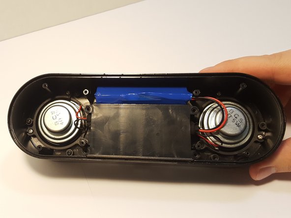

  5. Zenbre SoundBank Z3 Battery Replacement, Battery: crwdns2935265:05crwdnd2935265:01crwdnd2935265:02crwdne2935265:0 Zenbre SoundBank Z3 Battery Replacement, Battery: crwdns2935265:05crwdnd2935265:02crwdnd2935265:02crwdne2935265:0
    • Remove the battery from the holder. It may be difficult the first time.
    • Use a spudger between the battery and speaker wall to loosen it from its surroundings.
    • If the battery is punctured, leaking, or bloated/puffy, it may be hazardous and should be properly disposed of.
