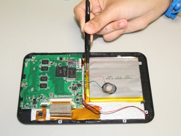

    • While wearing your antistatic wristband. Using a plastic spudger, remove the back casing of your tablet.
  2. Zeki TB782B Motherboard Replacement: crwdns2935265:02crwdnd2935265:01crwdnd2935265:01crwdne2935265:0
    • Using a #000 1.5 mm Phillips screwdriver, remove the screws along the inside of the device.
  3. Zeki TB782B Motherboard Replacement: crwdns2935265:03crwdnd2935265:01crwdnd2935265:02crwdne2935265:0 Zeki TB782B Motherboard Replacement: crwdns2935265:03crwdnd2935265:02crwdnd2935265:02crwdne2935265:0
    • Carefully disconnect the wires from the motherboard by rocking them back and forth until they come out.
  4. Zeki TB782B Motherboard Replacement: crwdns2935265:04crwdnd2935265:01crwdnd2935265:01crwdne2935265:0
    • At this point, you should be able to remove the motherboard.
Afterwards, you should have a fully functioning device.
