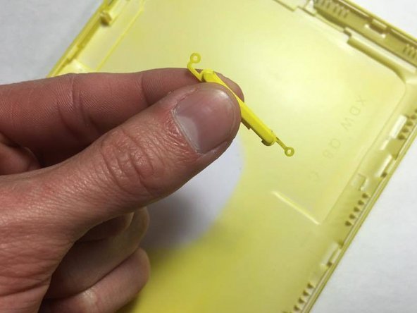

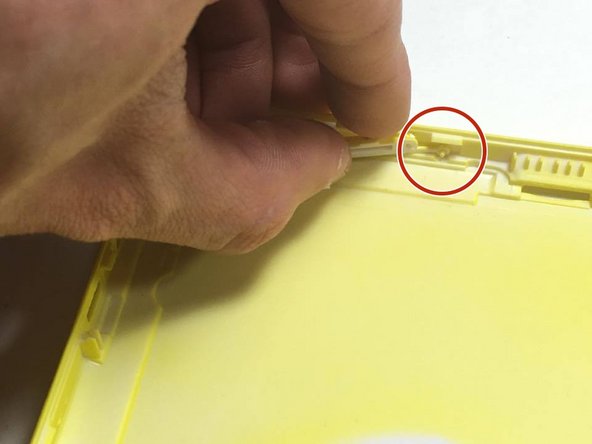

  4. Zeepad 7DRK Charging Port  Replacement: crwdns2935265:04crwdnd2935265:01crwdnd2935265:02crwdne2935265:0 Zeepad 7DRK Charging Port  Replacement: crwdns2935265:04crwdnd2935265:02crwdnd2935265:02crwdne2935265:0
    • In the first picture you will see the power button. Notice the small plastic ring that sticks out the side, this is so the piece can be positioned easily when you put it back together.
    • In the second picture, the volume control button is shown. Again notice the small locator rings.
  5. Zeepad 7DRK Charging Port  Replacement: crwdns2935265:05crwdnd2935265:01crwdnd2935265:02crwdne2935265:0 Zeepad 7DRK Charging Port  Replacement: crwdns2935265:05crwdnd2935265:02crwdnd2935265:02crwdne2935265:0
    • Now remove the old or broken buttons, and replace them.

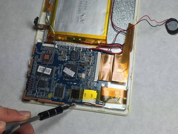

  6. Zeepad 7DRK Charging Port  Replacement, Charging Port: crwdns2935265:06crwdnd2935265:01crwdnd2935265:01crwdne2935265:0
    • With the two halves of the tablet apart, you will see the motherboard. It is held on by three screws as well as three wire strips.

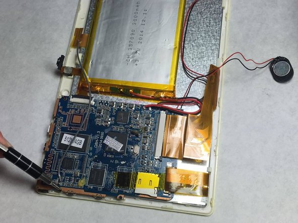

  7. Zeepad 7DRK Charging Port  Replacement: crwdns2935265:07crwdnd2935265:01crwdnd2935265:01crwdne2935265:0
    • Remove the pieces of tape attached to the motherboard so that it can be taken off.

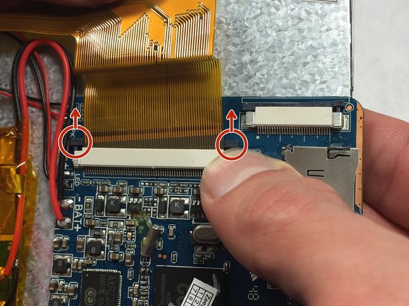

  8. Zeepad 7DRK Charging Port  Replacement: crwdns2935265:08crwdnd2935265:01crwdnd2935265:03crwdne2935265:0 Zeepad 7DRK Charging Port  Replacement: crwdns2935265:08crwdnd2935265:02crwdnd2935265:03crwdne2935265:0 Zeepad 7DRK Charging Port  Replacement: crwdns2935265:08crwdnd2935265:03crwdnd2935265:03crwdne2935265:0
    • There are three wire strips that connect to the motherboard via small plastic clips. they connect to the backlight, battery, and screen shown in the first image.
    • To detach the two connections on the left, for the screen and back-light, you must slide two blue tabs on either side of the wire strip upwards as shown in the second and third image.
  9. Zeepad 7DRK Charging Port  Replacement: crwdns2935265:09crwdnd2935265:01crwdnd2935265:03crwdne2935265:0 Zeepad 7DRK Charging Port  Replacement: crwdns2935265:09crwdnd2935265:02crwdnd2935265:03crwdne2935265:0 Zeepad 7DRK Charging Port  Replacement: crwdns2935265:09crwdnd2935265:03crwdnd2935265:03crwdne2935265:0
    • Take out the screws using a small phillip's head bit. The three locations of the screws are shown.
    • Be careful with the screw as they are small and easy to lose. Put them in a magnetic holder if possible.

  11. Zeepad 7DRK Charging Port  Replacement: crwdns2935265:011crwdnd2935265:01crwdnd2935265:01crwdne2935265:0
    • With all the plastic pieces that hold the wire strips in place loosened, you can take the wire strips out and remove the motherboard form the rest of the tablet.
    • Be careful not to break any of the other wired connections on the device.
    • Place it upside down on your work space and you will see the charging port.

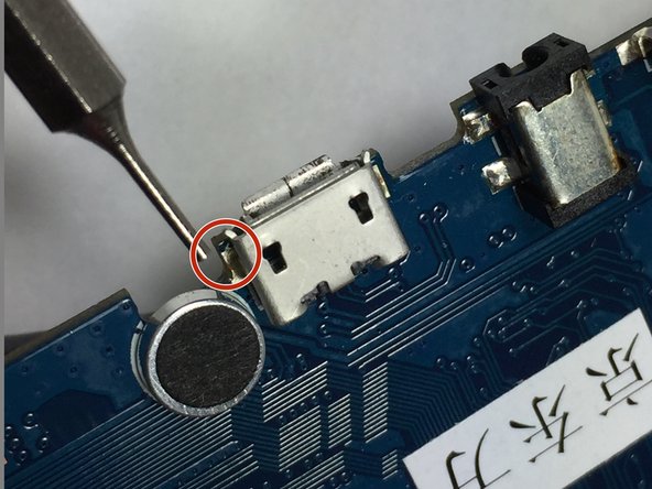

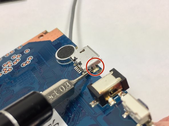

  12. Zeepad 7DRK Charging Port  Replacement: crwdns2935265:012crwdnd2935265:01crwdnd2935265:03crwdne2935265:0 Zeepad 7DRK Charging Port  Replacement: crwdns2935265:012crwdnd2935265:02crwdnd2935265:03crwdne2935265:0 Zeepad 7DRK Charging Port  Replacement: crwdns2935265:012crwdnd2935265:03crwdnd2935265:03crwdne2935265:0
    • The charging port is soldered onto the motherboard in four locations.
    • There are two points on the inward facing side as shown in the first image, and there is one point on either side of the port.
    • To completely remove the port, use a soldering iron to melt the solder holding on the port and gently disconnect the port form the motherboard.
    • If soldering is new to you, check out this helpful guide on soldering and desoldering connections.
