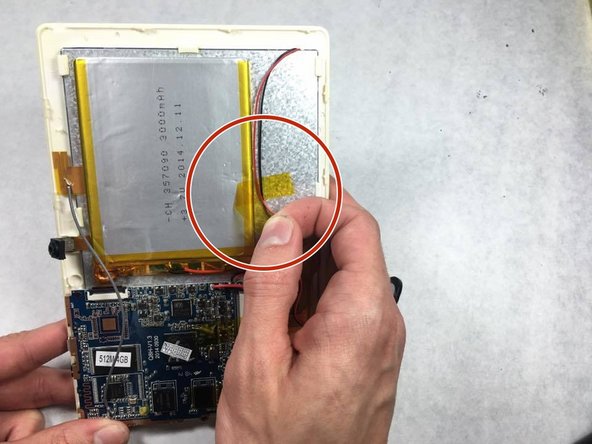

    • Once the back casing has been removed, identify the location of the battery inside the device, marked with the red circle.

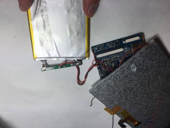

    • Identify the pieces of tape holding the battery to the back of the screen, and peel them off to remove them.

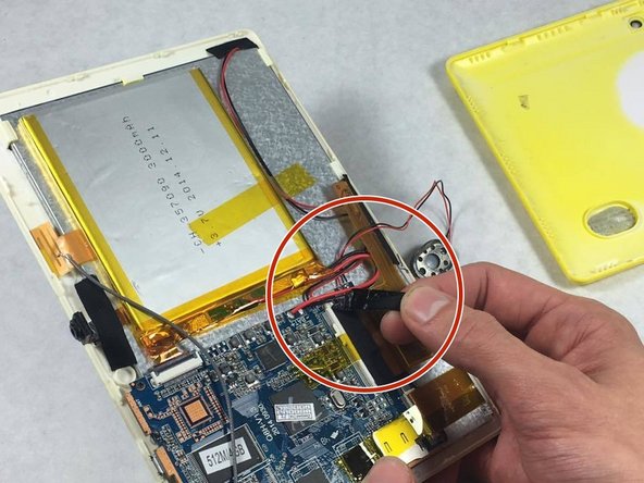

    • Locate the connection between the battery and motherboard, and disconnect it by pulling the two apart.

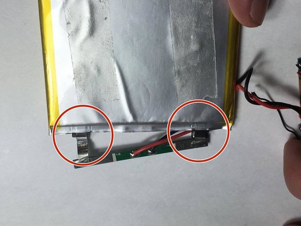

    • To finally finish removing the battery, the two wires connecting to it must be separated.
    • Peel back the tape covering the origin of the wires.
    • Finally, remove the two metal connectors attached to the green piece from the battery with a tug.
    • The battery has now been successfully removed.
