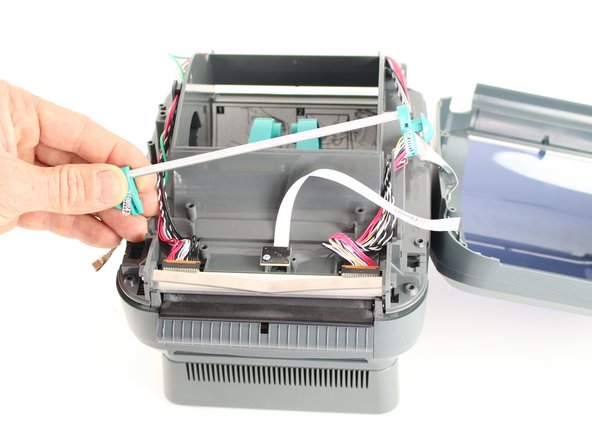

    • Remove the following screws securing the top cover of the ZP 505.
    • Six P1 9.0mm
    • One P0 19.0mm
  2. Zebra ZP 505 Latch Hook Replacement: crwdns2935265:02crwdnd2935265:01crwdnd2935265:01crwdne2935265:0
    • Close the printer.
    • Carefully remove the top cover and set it to the side.
  3. Zebra ZP 505 Latch Hook Replacement: crwdns2935265:03crwdnd2935265:01crwdnd2935265:01crwdne2935265:0
    • Locate the green wire on the front, left side of the printer and remove it.
  4. Zebra ZP 505 Latch Hook Replacement: crwdns2935265:04crwdnd2935265:01crwdnd2935265:02crwdne2935265:0 Zebra ZP 505 Latch Hook Replacement: crwdns2935265:04crwdnd2935265:02crwdnd2935265:02crwdne2935265:0
    • Pry out the tabs, making sure to hold the springs in place.
    • Once the tabs are out, remove the latch hook.
