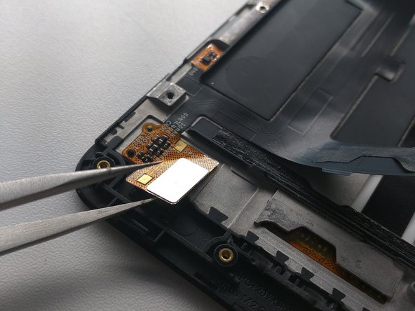

    2. ZTE ZMax Pro (Z981) Disassembly, Disconnect fingerprint sensor: crwdns2935265:02crwdnd2935265:01crwdnd2935265:03crwdne2935265:0 ZTE ZMax Pro (Z981) Disassembly, Disconnect fingerprint sensor: crwdns2935265:02crwdnd2935265:02crwdnd2935265:03crwdne2935265:0 ZTE ZMax Pro (Z981) Disassembly, Disconnect fingerprint sensor: crwdns2935265:02crwdnd2935265:03crwdnd2935265:03crwdne2935265:0
      • Remove Kapton tape covering fingerprint scanner cover
      • Unscrew two screws holding on fingerprint scanner flex cover
      • Along with that upper screw, there goes your warranty!
      • Disconnect fingerprint sensor flex cable and set rear cover aside.

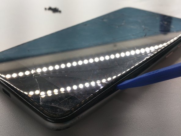

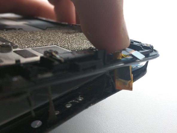

    3. ZTE ZMax Pro (Z981) Disassembly: crwdns2935265:04crwdnd2935265:01crwdnd2935265:03crwdne2935265:0 ZTE ZMax Pro (Z981) Disassembly: crwdns2935265:04crwdnd2935265:02crwdnd2935265:03crwdne2935265:0 ZTE ZMax Pro (Z981) Disassembly: crwdns2935265:04crwdnd2935265:03crwdnd2935265:03crwdne2935265:0
      • Carefully insert pry tool on side of phone between LCD and frame
      • Continue down the side the phone and around the edges until frame and LCD assembly are separated
      • Ta-da!
      • Don't laugh at my terrible Photoshop cropping.

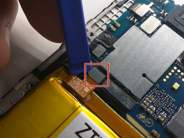

    4. ZTE ZMax Pro (Z981) Disassembly: crwdns2935265:05crwdnd2935265:01crwdnd2935265:03crwdne2935265:0 ZTE ZMax Pro (Z981) Disassembly: crwdns2935265:05crwdnd2935265:02crwdnd2935265:03crwdne2935265:0 ZTE ZMax Pro (Z981) Disassembly: crwdns2935265:05crwdnd2935265:03crwdnd2935265:03crwdne2935265:0
      • Remove Kapton tape over battery plug
      • Disconnect battery
      • Disconnect this other flex cable above the battery, whatever it goes to

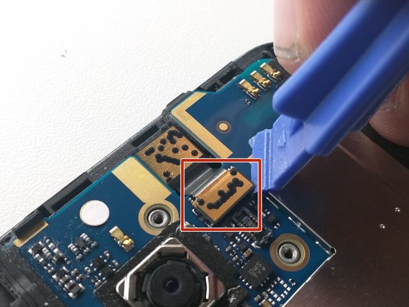

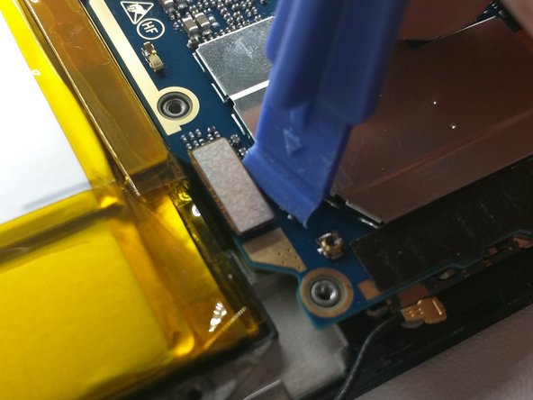

    5. ZTE ZMax Pro (Z981) Disassembly: crwdns2935265:06crwdnd2935265:01crwdnd2935265:03crwdne2935265:0 ZTE ZMax Pro (Z981) Disassembly: crwdns2935265:06crwdnd2935265:02crwdnd2935265:03crwdne2935265:0 ZTE ZMax Pro (Z981) Disassembly: crwdns2935265:06crwdnd2935265:03crwdnd2935265:03crwdne2935265:0
      • Disconnect this one
      • Now this one
      • And this camera one also

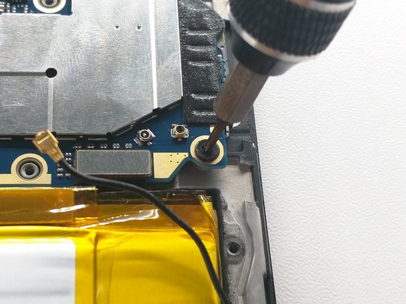

    6. ZTE ZMax Pro (Z981) Disassembly: crwdns2935265:07crwdnd2935265:01crwdnd2935265:03crwdne2935265:0 ZTE ZMax Pro (Z981) Disassembly: crwdns2935265:07crwdnd2935265:02crwdnd2935265:03crwdne2935265:0 ZTE ZMax Pro (Z981) Disassembly: crwdns2935265:07crwdnd2935265:03crwdnd2935265:03crwdne2935265:0
      • Disconnect antenna
      • Unscrew motherboard screw
      • Disconnect LCD flex cable

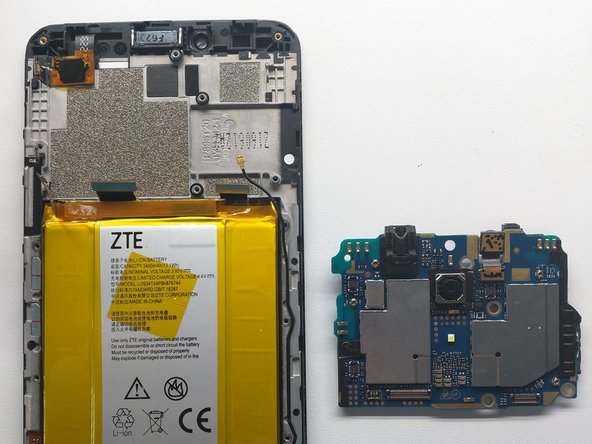

    7. ZTE ZMax Pro (Z981) Disassembly: crwdns2935265:08crwdnd2935265:01crwdnd2935265:02crwdne2935265:0 ZTE ZMax Pro (Z981) Disassembly: crwdns2935265:08crwdnd2935265:02crwdnd2935265:02crwdne2935265:0
      • Lift out logic board
      • Easy
      • Now on to the fun part...

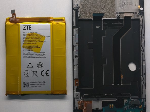

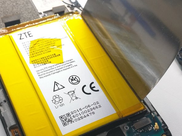

    8. ZTE ZMax Pro (Z981) Disassembly, Battery Removal: crwdns2935265:09crwdnd2935265:01crwdnd2935265:03crwdne2935265:0 ZTE ZMax Pro (Z981) Disassembly, Battery Removal: crwdns2935265:09crwdnd2935265:02crwdnd2935265:03crwdne2935265:0 ZTE ZMax Pro (Z981) Disassembly, Battery Removal: crwdns2935265:09crwdnd2935265:03crwdnd2935265:03crwdne2935265:0
      • Heat up battery
      • Heating a battery is dangerous and could cause the battery to explode or expand. Use caution.
      • Find appropriate tool to pry battery
      • Ensure your tool of choice is heat resistant
    9. ZTE ZMax Pro (Z981) Disassembly: crwdns2935265:010crwdnd2935265:01crwdnd2935265:03crwdne2935265:0 ZTE ZMax Pro (Z981) Disassembly: crwdns2935265:010crwdnd2935265:02crwdnd2935265:03crwdne2935265:0 ZTE ZMax Pro (Z981) Disassembly: crwdns2935265:010crwdnd2935265:03crwdnd2935265:03crwdne2935265:0
      • Once you have found the proper tool, begin prying up on either side of the battery.
      • If utilizing a metal ruler, make sure to use a pink one. Other colors of ruler, such as blue or green, are simply not up to the task.
      • Be careful not to damage previously disconnected flex cables that run under the battery.
      • Finally, bend the battery back into shape so it doesn't look too bad in your photos.

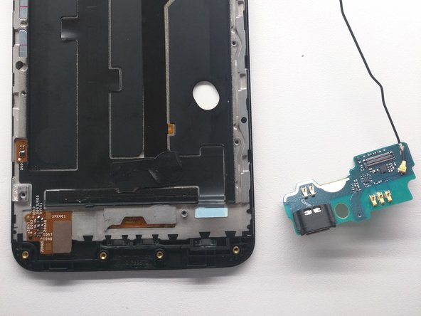

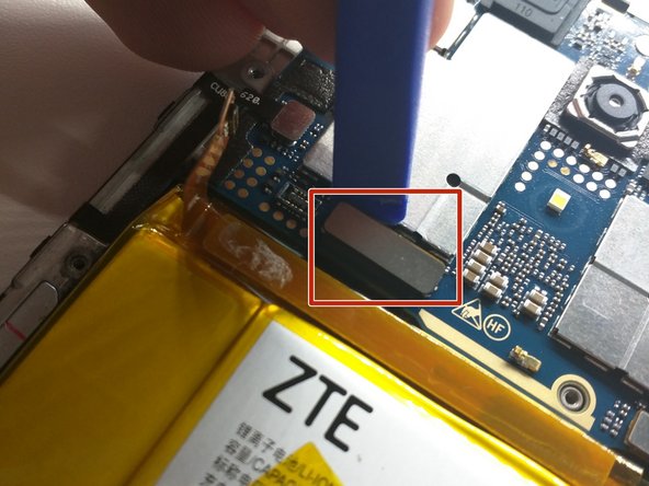

    10. ZTE ZMax Pro (Z981) Disassembly, Charging Port Removal: crwdns2935265:011crwdnd2935265:01crwdnd2935265:03crwdne2935265:0 ZTE ZMax Pro (Z981) Disassembly, Charging Port Removal: crwdns2935265:011crwdnd2935265:02crwdnd2935265:03crwdne2935265:0 ZTE ZMax Pro (Z981) Disassembly, Charging Port Removal: crwdns2935265:011crwdnd2935265:03crwdnd2935265:03crwdne2935265:0
      • Remove tape holding charging board down (red outline)
      • Pry up charging port / antenna daughterboard.
      • Remove from frame and set aside

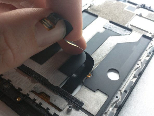

    11. ZTE ZMax Pro (Z981) Disassembly: crwdns2935265:012crwdnd2935265:01crwdnd2935265:03crwdne2935265:0 ZTE ZMax Pro (Z981) Disassembly: crwdns2935265:012crwdnd2935265:02crwdnd2935265:03crwdne2935265:0 ZTE ZMax Pro (Z981) Disassembly: crwdns2935265:012crwdnd2935265:03crwdnd2935265:03crwdne2935265:0
      • Lift up digitizer flex cable from frame
      • Peel up this flex cable and tweezer it off where it's stuck to the frame
      • Peel up the LCD flex cable

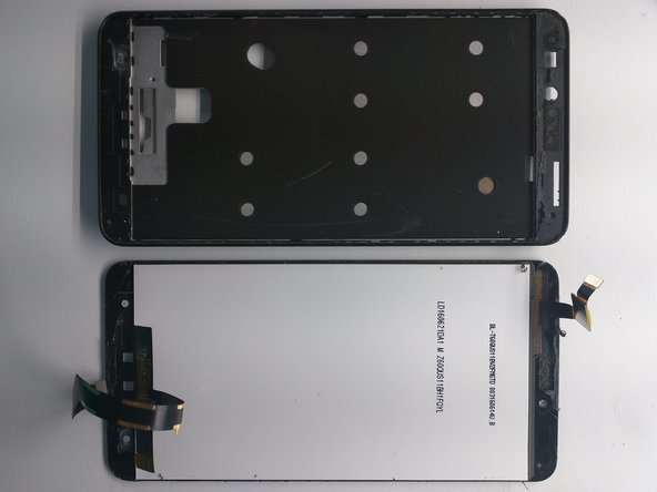

    12. ZTE ZMax Pro (Z981) Disassembly: crwdns2935265:013crwdnd2935265:01crwdnd2935265:03crwdne2935265:0 ZTE ZMax Pro (Z981) Disassembly: crwdns2935265:013crwdnd2935265:02crwdnd2935265:03crwdne2935265:0 ZTE ZMax Pro (Z981) Disassembly: crwdns2935265:013crwdnd2935265:03crwdnd2935265:03crwdne2935265:0
      • Slide something in between the screen and frame.
      • Make sure to slide it in there real nice
      • Separate LCD assembly from frame, starting at the bottom.

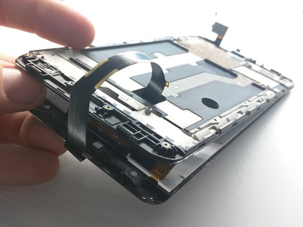

    13. ZTE ZMax Pro (Z981) Disassembly: crwdns2935265:014crwdnd2935265:01crwdnd2935265:03crwdne2935265:0 ZTE ZMax Pro (Z981) Disassembly: crwdns2935265:014crwdnd2935265:02crwdnd2935265:03crwdne2935265:0 ZTE ZMax Pro (Z981) Disassembly: crwdns2935265:014crwdnd2935265:03crwdnd2935265:03crwdne2935265:0
      • Push digitizer flex cable through frame
      • Remove LCD assembly from phone

Does the digitizer snap in? Or will I need adhesive to install my new digitizer?? Other phones that I have replaced the digitizer I needed adhesive, but I know some just snap in. I'm hoping this is one of those that just snap in.
thestoryofrecovery - crwdns2934203:0crwdne2934203:0 crwdns2950251:0crwdne2950251:0
With this phone, you would need new adhesive. I would recommend using the 2mm Tessa 61395 tape ( Tesa 61395 Tape )
Nate Evans - crwdns2934203:0crwdne2934203:0 crwdns2950251:0crwdne2950251:0
So is it even possible to actually just replace the digitizer? Because it seems like in getting it out I took the lcd with it?? is that "always" the case???
Dave K - crwdns2934203:0crwdne2934203:0 crwdns2950251:0crwdne2950251:0
The digitizer may be built into the LCD panel it self, it's not uncommon. If that's the case, no, it would not be possible to replace just the digitizer. And the cost to difficulty ratio would be rather low
Is it possible to replace just the lcd glass (front piece) and not the lcd digitizer, or are they glued together? Some places sell just the glass and that's all that's broken on my phone.
