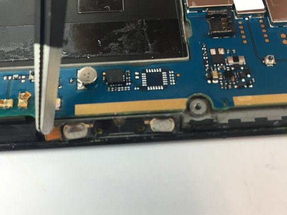

  7. ZTE ZMAX Z970 Volume Button Replacement, Volume Button: crwdns2935265:07crwdnd2935265:01crwdnd2935265:02crwdne2935265:0 ZTE ZMAX Z970 Volume Button Replacement, Volume Button: crwdns2935265:07crwdnd2935265:02crwdnd2935265:02crwdne2935265:0
    • Peel off circuit board carefully.
    • The new part will need to be soldered onto the motherboard.
