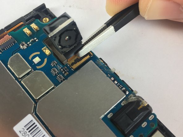

  7. ZTE ZMAX Z970 Rear Camera Replacement, Rear Camera: crwdns2935265:07crwdnd2935265:01crwdnd2935265:02crwdne2935265:0 ZTE ZMAX Z970 Rear Camera Replacement, Rear Camera: crwdns2935265:07crwdnd2935265:02crwdnd2935265:02crwdne2935265:0
    • Disconnect the camera from the motherboard with the flat end of a spudger.
    • Remove carefully with tweezers.
