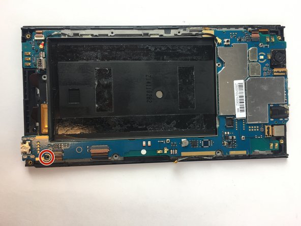

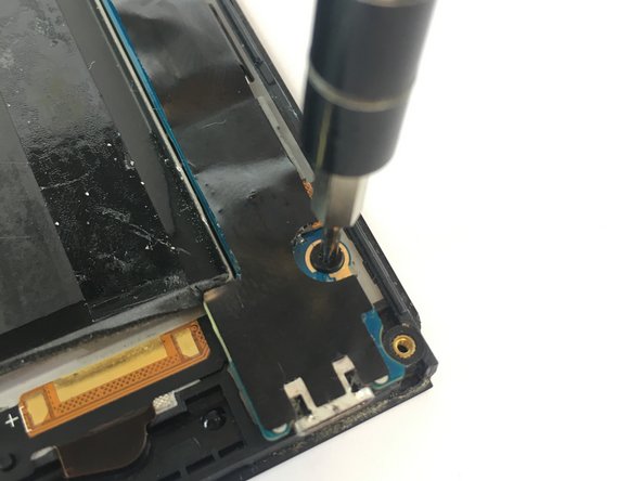

  7. ZTE ZMAX Z970 Power Button Replacement, Power Button: crwdns2935265:07crwdnd2935265:01crwdnd2935265:03crwdne2935265:0 ZTE ZMAX Z970 Power Button Replacement, Power Button: crwdns2935265:07crwdnd2935265:02crwdnd2935265:03crwdne2935265:0 ZTE ZMAX Z970 Power Button Replacement, Power Button: crwdns2935265:07crwdnd2935265:03crwdnd2935265:03crwdne2935265:0
    • Remove the black tape covering the motherboard.
    • Remove the single 1.2mm screw with a Phillips #000 screwdriver.

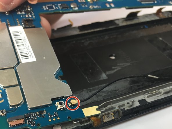

  8. ZTE ZMAX Z970 Power Button Replacement: crwdns2935265:08crwdnd2935265:01crwdnd2935265:03crwdne2935265:0 ZTE ZMAX Z970 Power Button Replacement: crwdns2935265:08crwdnd2935265:02crwdnd2935265:03crwdne2935265:0 ZTE ZMAX Z970 Power Button Replacement: crwdns2935265:08crwdnd2935265:03crwdnd2935265:03crwdne2935265:0
    • Use the flat end of the spudger to release the upper left and right prongs that secure the motherboard.
    • Detach the antenna cable.

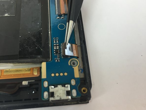

  9. ZTE ZMAX Z970 Power Button Replacement: crwdns2935265:09crwdnd2935265:01crwdnd2935265:03crwdne2935265:0 ZTE ZMAX Z970 Power Button Replacement: crwdns2935265:09crwdnd2935265:02crwdnd2935265:03crwdne2935265:0 ZTE ZMAX Z970 Power Button Replacement: crwdns2935265:09crwdnd2935265:03crwdnd2935265:03crwdne2935265:0
    • Lift up the tan flap on the three ZIF connectors.
    • Pull the ribbon out of the now unlocked ZIF connectors.

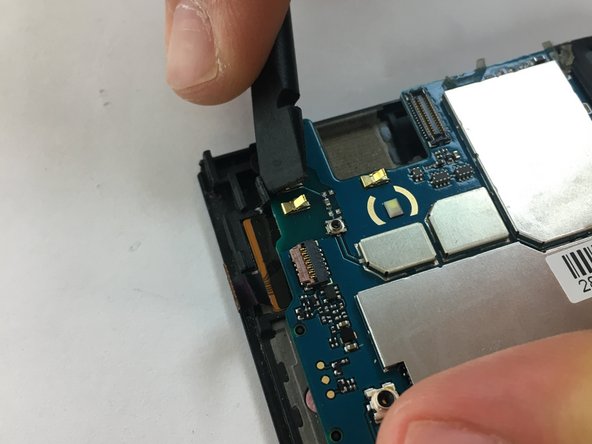

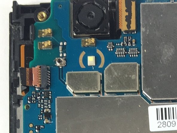

  10. ZTE ZMAX Z970 Power Button Replacement: crwdns2935265:010crwdnd2935265:01crwdnd2935265:02crwdne2935265:0 ZTE ZMAX Z970 Power Button Replacement: crwdns2935265:010crwdnd2935265:02crwdnd2935265:02crwdne2935265:0
    • Lift the covering panel below the motherboard covering and connecting the power button.
    • Disconnect the circuit tape of the power button and remove the power button.
    • The power button in these photos has been damaged and not soldered to the motherboard.
    • The new power button will have to be desoldered to the mother board.
