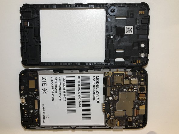

    • Unscrew all 16 screws from the mid-frame with a J000 screwdriver.
  4. ZTE ZFive G LTE Volume and Power Button Replacement: crwdns2935265:04crwdnd2935265:01crwdnd2935265:02crwdne2935265:0 ZTE ZFive G LTE Volume and Power Button Replacement: crwdns2935265:04crwdnd2935265:02crwdnd2935265:02crwdne2935265:0
    • Being careful with the device, gently pull up the device body tugging from the inside of the device.
    • Be sure to pull away from the device.

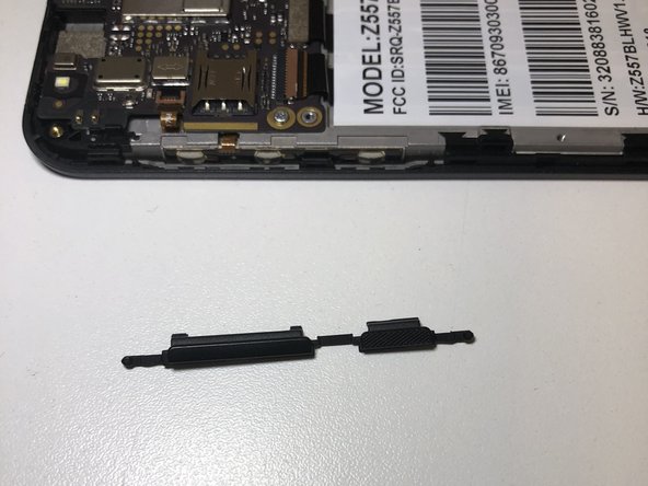

  5. ZTE ZFive G LTE Volume and Power Button Replacement: crwdns2935265:05crwdnd2935265:01crwdnd2935265:02crwdne2935265:0 ZTE ZFive G LTE Volume and Power Button Replacement: crwdns2935265:05crwdnd2935265:02crwdnd2935265:02crwdne2935265:0
    • Carefully use a pair of bent nose tweezers to pull out the button cover. I should come out easily.
