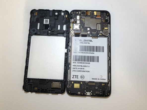

  4. ZTE ZFive G LTE Front-Facing Camera  Replacement: crwdns2935265:04crwdnd2935265:01crwdnd2935265:02crwdne2935265:0 ZTE ZFive G LTE Front-Facing Camera  Replacement: crwdns2935265:04crwdnd2935265:02crwdnd2935265:02crwdne2935265:0
    • Gently pull up the device body from the inside.
    • Make sure to pull on all four sides as shown here.

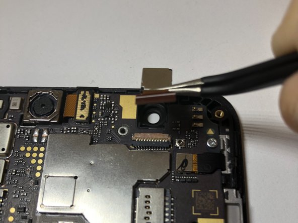

  5. ZTE ZFive G LTE Front-Facing Camera  Replacement: crwdns2935265:05crwdnd2935265:01crwdnd2935265:02crwdne2935265:0 ZTE ZFive G LTE Front-Facing Camera  Replacement: crwdns2935265:05crwdnd2935265:02crwdnd2935265:02crwdne2935265:0
    • Once the body is removed, you will see the front facing camera at the top right corner of the device.
    • Using an opening tool, lift up the protective clip on top of the camera's ribbon wire.
  6. ZTE ZFive G LTE Front-Facing Camera  Replacement: crwdns2935265:06crwdnd2935265:01crwdnd2935265:02crwdne2935265:0 ZTE ZFive G LTE Front-Facing Camera  Replacement: crwdns2935265:06crwdnd2935265:02crwdnd2935265:02crwdne2935265:0
    $3.99
    • Using angled tweezers, gently pull the ribbon wire up from the body.
    • With the ribbon wire out, you should be able to remove the camera.
    • If there is adhesive on the camera backing, it may require more force to pull the camera out.
