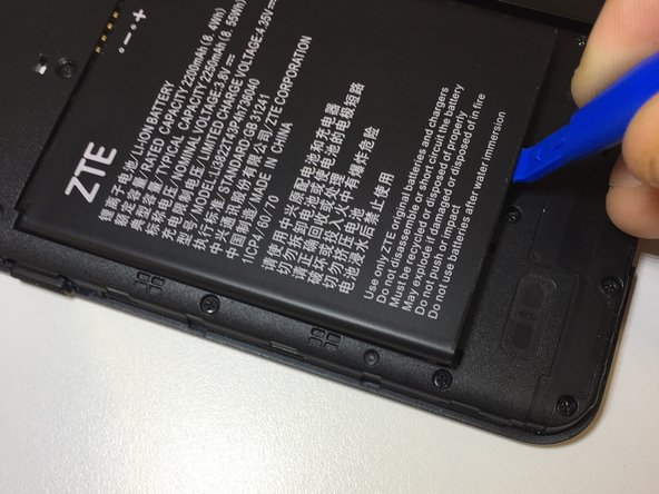

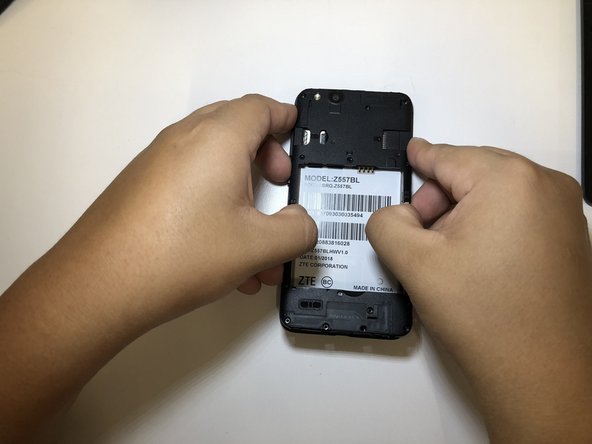

    • Pry open back cover of the device from the crease at the bottom left corner with an opening tool or fingernail.
  2. ZTE ZFive G LTE Back Camera Replacement: crwdns2935265:02crwdnd2935265:01crwdnd2935265:02crwdne2935265:0 ZTE ZFive G LTE Back Camera Replacement: crwdns2935265:02crwdnd2935265:02crwdnd2935265:02crwdne2935265:0
    • Remove all 16 screws with a J000 screwdriver.

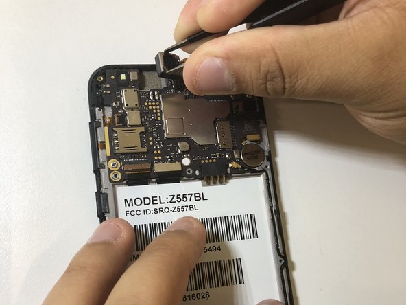

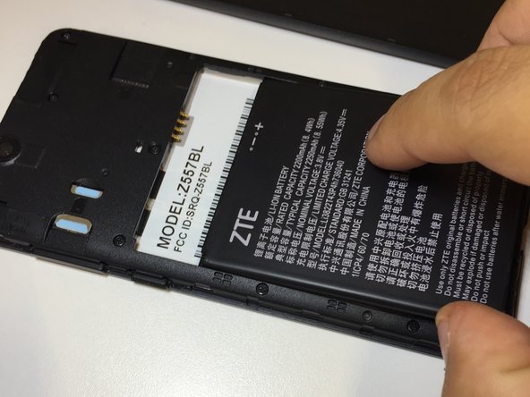

    • Remove the battery with an opening tool or fingernail.
  4. ZTE ZFive G LTE Back Camera Replacement: crwdns2935265:04crwdnd2935265:01crwdnd2935265:03crwdne2935265:0 ZTE ZFive G LTE Back Camera Replacement: crwdns2935265:04crwdnd2935265:02crwdnd2935265:03crwdne2935265:0 ZTE ZFive G LTE Back Camera Replacement: crwdns2935265:04crwdnd2935265:03crwdnd2935265:03crwdne2935265:0

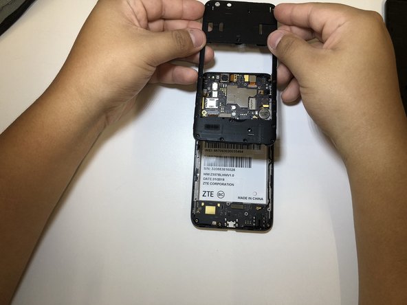

    • Gently pry open the device body by tugging from the inside out, be sure to pull up and away from device.
  5. ZTE ZFive G LTE Back Camera Replacement: crwdns2935265:05crwdnd2935265:01crwdnd2935265:03crwdne2935265:0 ZTE ZFive G LTE Back Camera Replacement: crwdns2935265:05crwdnd2935265:02crwdnd2935265:03crwdne2935265:0 ZTE ZFive G LTE Back Camera Replacement: crwdns2935265:05crwdnd2935265:03crwdnd2935265:03crwdne2935265:0

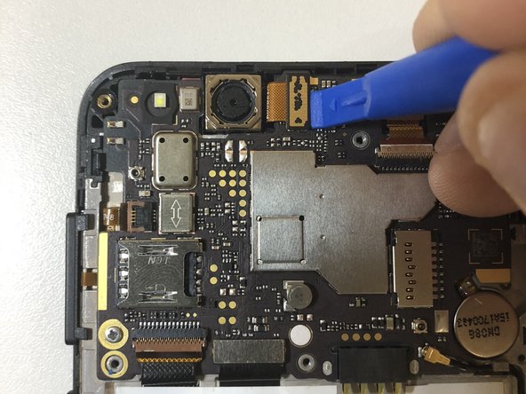

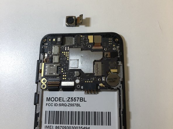

    • Once body is removed, back-facing camera is placed at the top left corner of device.
    • Using an opening tool, pull up the tab of the camera wire ribbon.
  6. ZTE ZFive G LTE Back Camera Replacement: crwdns2935265:06crwdnd2935265:01crwdnd2935265:03crwdne2935265:0 ZTE ZFive G LTE Back Camera Replacement: crwdns2935265:06crwdnd2935265:02crwdnd2935265:03crwdne2935265:0 ZTE ZFive G LTE Back Camera Replacement: crwdns2935265:06crwdnd2935265:03crwdnd2935265:03crwdne2935265:0

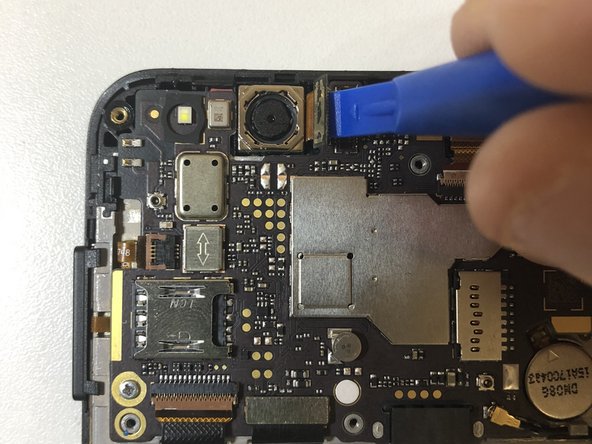

    • Using the blunt-nose tweezers, tug at the camera gently, switching sides to remove adhesive little by little, pull camera out gently.
